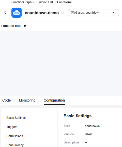

Creating an Alias
- Log in to the FunctionGraph console. In the navigation pane, choose Functions > Function List.
- Click the name of a function.
- On the Aliases tab page, click Create Alias. Create an alias to point to the current function version. You can use the alias to invoke this version.

- Click OK. The alias function details page is displayed.
Figure 1 Creating an alias
