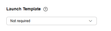

  1. Set Launch Template.
    By default, Not required is selected. If you want to use the parameters preset in a launch template to quickly configure ECSs, select Launch Template.
    Figure 2 Launch template
    1. Select a template region from the drop-down list.
    2. Select a launch template from the drop-down list.
      After you select a launch template, the system automatically presets the ECS purchase parameters based on the configuration information in the launch template.
    3. In the Configuration Summary area on the right of the page, view the preset parameters.
