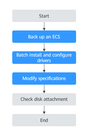

Process
| Step | Description |
| 1 | |
| 2 | |
| 3 | |
| 4 |
