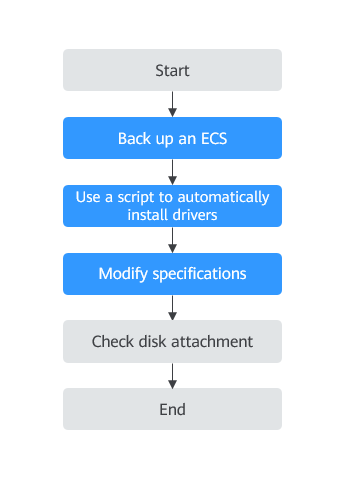

Figure 1 shows the flowchart for automatically changing a Xen ECS to a KVM ECS.
Figure 1 Flowchart for automatically changing a Xen ECS to a KVM ECS
Table 1 describes the operations for automatically changing a Xen ECS to a KVM ECS using a script.
Table 1 Procedure for automatically changing a Xen ECS to a KVM ECS using a script
