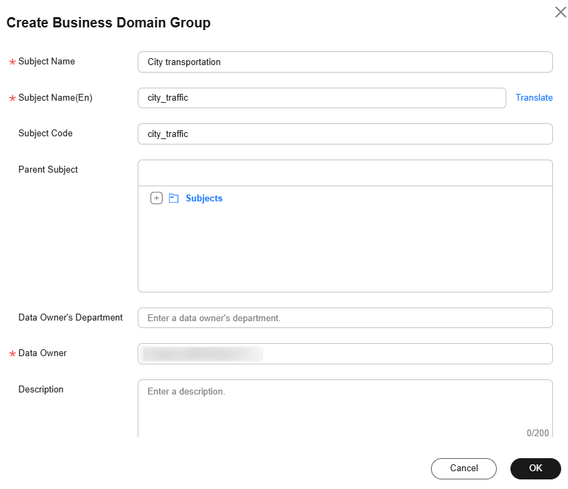

     - On the DataArts Architecture console, choose  in the left navigation pane. On the page displayed, click Create to create an L1 subject, which is a subject area group.
In the dialog box displayed, set the parameters as shown in Figure 5 and click OK.
 - Select the created subject area group and click publish. In the Apply for Publication dialog box, select a reviewer and click OK. Wait for the reviewer to review the application. If you have the reviewer permissions, select Auto-review and click OK.
    Figure 6 Publishing a subject area group
