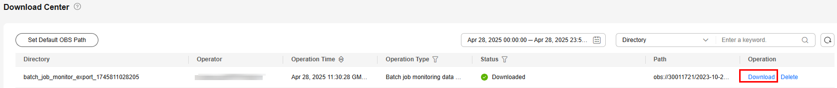

| Exporting all data | Click Export All Data. After the export is complete, you can go to the Download Center page and view and download the exported file. Figure 2 Viewing export history If the default storage path is not configured, you can set a storage path and select Set as default OBS path in the Export to OBS dialog box. A maximum of 30 MB data can be exported. If there are more than 30 MB data, the data will be automatically truncated. The exported job instances map job nodes. You cannot export data by selecting job names. Instead, you can select the data to be exported by setting filter criteria. |
