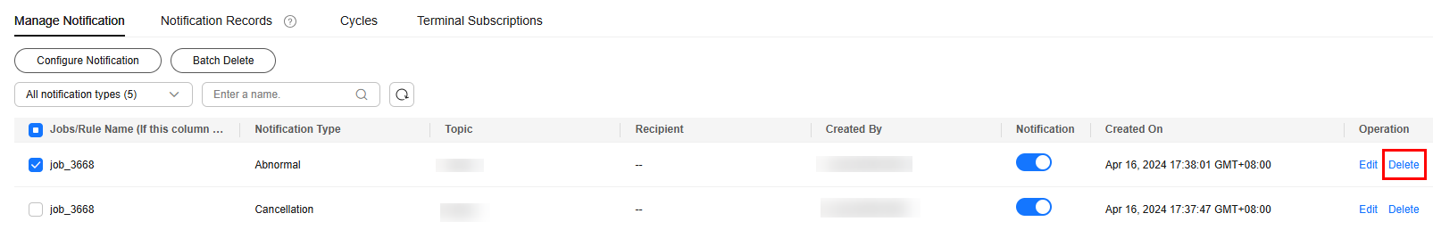

  3. You can delete a notification in either of the following ways:
    Figure 4 Deleting a notification
    • In the Operation column of a notification, click Delete.
    • Select the notifications to delete and click Batch Delete above the notification list.
  4. In the displayed dialog box, click OK.
