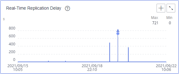

The following figure shows a Cloud Eye console display indicating that the Real-Time Replication Delay metric of a read replica increased sharply and then fell back down again.

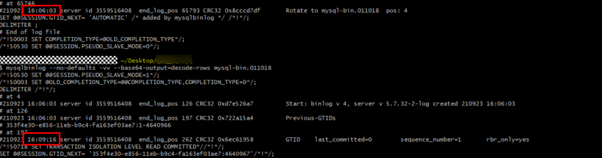

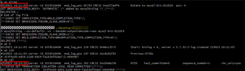

The following symptom was found in the binlog files generated during the period when the replication delay increased sharply and then fell back:
The difference between the start time of the first transaction in the new binlog file and the end time of the last transaction in the previous binlog file was the same as the difference between the sudden increase and fallback times.
