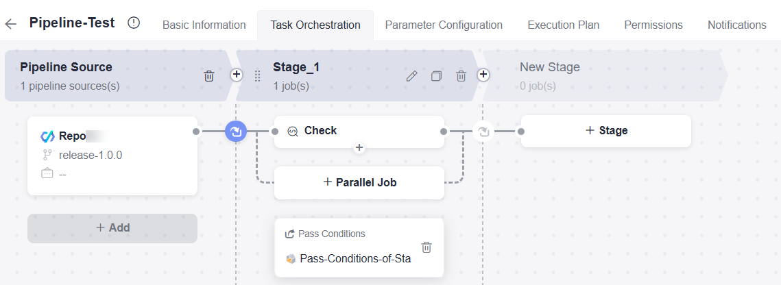

- Go to the Task Orchestration page. Two stages (Pipeline Source and Stage_1) are generated by default. You can add code check or build jobs as needed.

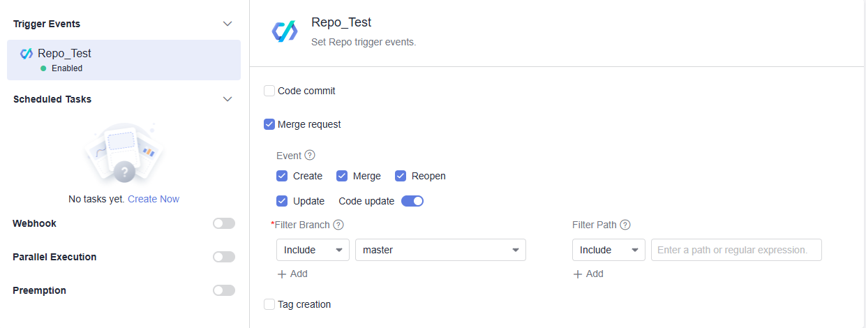

- Click the Execution Plan tab and configure Repo trigger events. Select Merge request, set events, filter branches, and filter paths. For details, see Configuring Event Triggers.

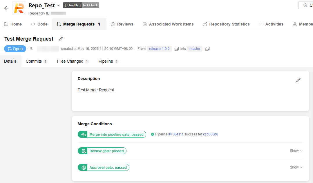

- Access the Repo_Test repository created in Preparations, choose Settings > Policy Settings > Merge Requests. In the Branch Policies area, click Create Branch Policy, select or enter a branch, select Enable pipeline gate, and click OK.
- Click the Merge Requests tab. On the displayed page, create a merge request in Repo_Test to trigger the pipeline. The pipeline running status will be displayed in the Merge Conditions area.
