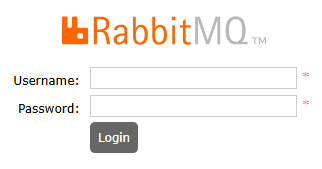

- Enter http://EIP:15672 in the address bar to access RabbitMQ. If the following page is displayed, RabbitMQ has been installed.

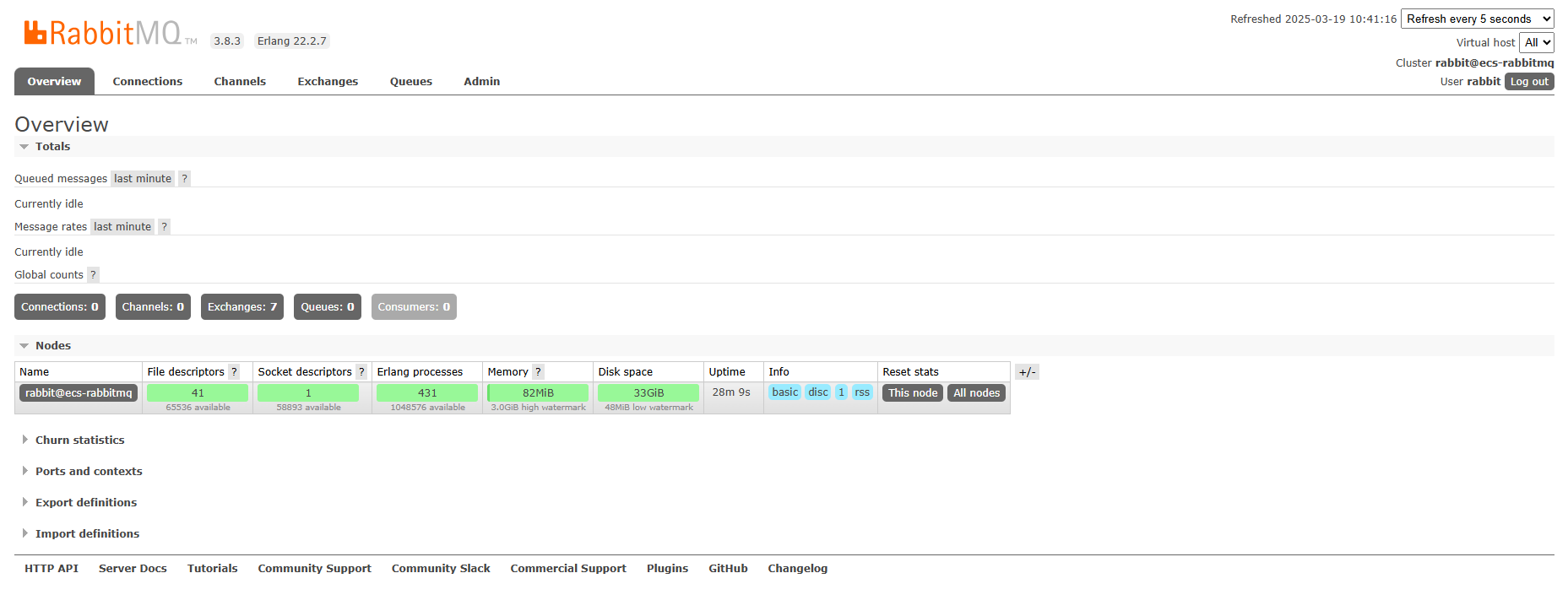

- Enter the created username and password to go to the RabbitMQ management page.
