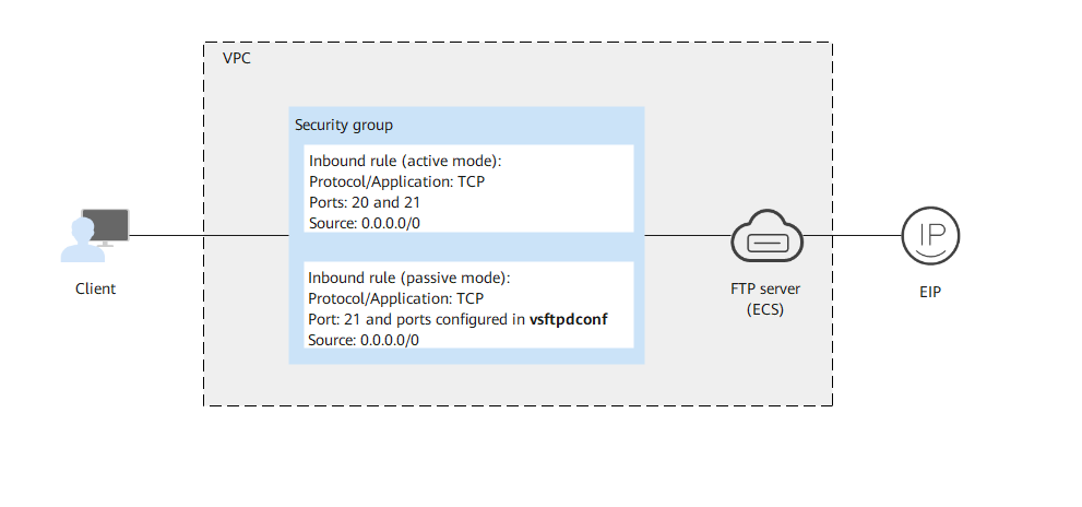

This section guides you through the setup of an FTP site on a Linux ECS using vsftpd. vsftpd is an FTP server software that is widely used in Linux releases. The following uses Ubuntu 22.04 or Debian 12.0.0 64 as an example.
Solution Architecture
Advantages
- A website with a simple networking architecture can be quickly set up.
- The website is secure and easy to use.
Resource Planning
| Resource | Description | Cost |
| VPC | VPC CIDR block: 192.168.0.0/16 | Free |
| VPC subnet |
| Free |
| Security group | Inbound rule (active mode):
Inbound rule (passive mode):
| Free |
| ECS |
| The following resources generate costs:
For billing details, see Billing Mode Overview. |
| vsftpd | A free, open-source FTP software. | Free |
