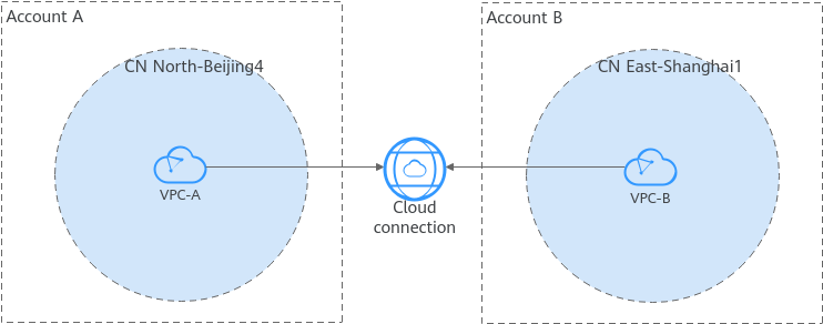

Solution Architecture
A company has two Huawei accounts (accounts A and B). Account A has a VPC in CN North-Beijing4 and account B has a VPC in CN East-Shanghai1.
To connect the two VPCs, the company needs to create a cloud connection and load the VPCs to the cloud connection.
Figure 1 Connecting VPCs in different regions and accounts

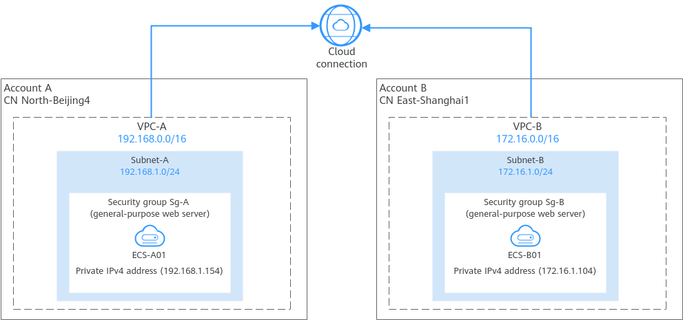

Network Planning
Figure 2 and Table 1 show the network planning and description for communication between VPCs in different regions and accounts.
Figure 2 Networking planning for connecting VPCs in different regions under different accounts
Table 1 Networking planning description

Resource Planning
The VPCs and ECSs must be in different regions, and they can be in any AZ.
The following resource details are only for your reference. You can modify them if needed.
  • Table 2 describes the two VPCs in detail. Their CIDR blocks cannot overlap with each other.

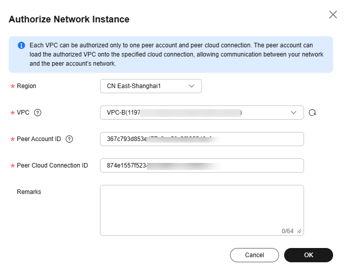

Step 4: Request Permission to Use the VPC in Another Account
If the VPC in your account (account A) needs to communicate with that in another account (account B), ask account B to grant you (account A) the permission to load their VPC to your cloud connection.
In this example, log in to the console as account B and take the following steps to grant account A the permission to load account B's VPC to account A's cloud connection:
  1. Go to the Cross-Account Authorization page.
  2. On the Network Instances Authorized by Me tab, click Authorize Network Instance.
  3. Configure the parameters based on Table 9.
    Figure 4 Cross-account authorization
    Table 9 Parameters for cross-account authorization
    Parameter
    Description
    Example Value
    Region
    Specifies the region where the VPC is located.
    CN East-Shanghai1
    VPC
    Specifies the VPC you want to authorize.
    VPC-B
    Peer Account ID
    Specifies the ID of the peer account.
    ID of account A
    Peer Cloud Connection ID
    Specifies the ID of the peer cloud connection that the VPC is to be loaded to.
    ID of the cloud connection cc-test created in account A
    Remarks
    Provides supplementary information about cross-account authorization.
  4. Click OK. Account A can access the resources in VPC-B of account B.
