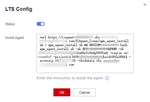

- Install the ICAgent in the bastion host system.
- Log in to your bastion host.
- Choose System > System Config > Outgoing.
- On the displayed page, locate the LTS Config area and click Edit.
- Click
to enable the LTS service, and enter the command processed in 2 in the Install Agent text box.
Figure 2 Example for V3.3.54.0 and later
- Click OK.
You can click Go to the task center in the displayed dialog box to view the task progress and status in the task center.
