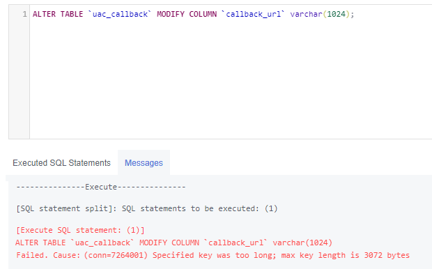

The alter table command failed to modify a table structure. The following error information was displayed:
Specified key was too long; max key length is 3072 bytes

The table structure is as follows:
CREATE TABLE `xxxxx` (
`subscription_type` varchar(64) NOT NULL DEFAULT 'DEVICE_EXCEPTION' COMMENT 'Subscription type',
`auth_key` varchar(255) DEFAULT'' COMMENT 'Signature. A token is added to the API request header based on the value of this parameter',
`create_time` timestamp NOT NULL DEFAULT CURRENT_TIMESTAMP COMMENT 'Creation time',
`update_time` timestamp NOT NULL DEFAULT CURRENT_TIMESTAMP ON UPDATE CURRENT_TIMESTAMP COMMENT 'Update time',
PRIMARY KEY (`id`) USING BTREE,
UNIQUE KEY `enterprise_id` (`subscription_type`,`enterprise_id`,`callback_url`) USING BTREE)
) ENGINE=InnoDB AUTO_INCREMENT=1039 DEFAULT CHARSET=utf8 ROW_FORMAT=DYNAMIC
This table uses the utf8 character set. Each character occupies three bytes. The composite index enterprise_id contains the callback_url column. If a DDL operation is performed and callback_url to is changed to varchar(1024), the maximum length of the composite index is exceeded. As a result, an error is reported.
