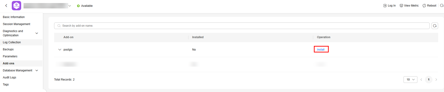

- On the Instances page, click the name of the target instance to go to the Basic Information page.
- In the navigation pane, choose Add-ons.
- Click Install in the Operation column of the row containing the postgis add-on.
Figure 1 Installing the PostGIS add-on

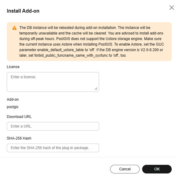

- Enter the license, download URL, and SHA-256 hash, and click OK.
Figure 2 Installing the add-on
Table 1 Parameter description Parameter
Description
License
License provided by the third-party vendor. To obtain it, send the equipment serial number (ESN) to the third-party vendor. The ESN is the ID of the instance where the add-on is to be installed.
Add-on
Name of the add-on to be installed. The default add-on name is postgis.
Download URL
Shared object URL of the add-on package provided in OBS.
For details, see Accessing an Object Using Its URL.
SHA-256 Hash
SHA-256 hash provided by the third-party vendor.
