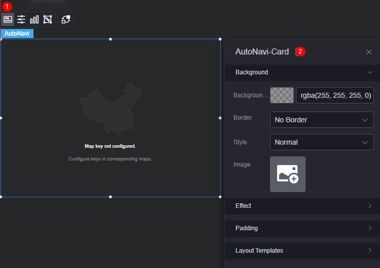

Card
A card wraps a chart widget. A widget consists of card elements (card title, chart, card background, and card border) and chart elements.
Figure 3 Amap card
  • Background
    • Background color: Background color of the widget card.
    • Border: Border of the widget card. Options: no border, full border, and corner border. For full border and corner border, you can set the line type and rounded corners of the outer border of the widget.
    • Style: Image display style. The options are normal, center, stretch, and tiled.
    • Choose image: Use a local image as the widget background. Directories and subdirectories can be added to facilitate image management by category. JPG, JPEG, PNG, or GIF images are recommended. The size of each image cannot exceed 50 MB.
  • Special effect: Widget highlighted status. Displayed by default or on page load.
  • Padding: distance between the chart and the four sides (top, bottom, left, and right as shown in Figure 2) of the widget. The default value is 0, indicating that the chart stretches to fill the entire widget.
  • Layout template > map style: Select a map style from the drop-down list box, for example, control + label layer, default style, or map administrative region + icon layer.

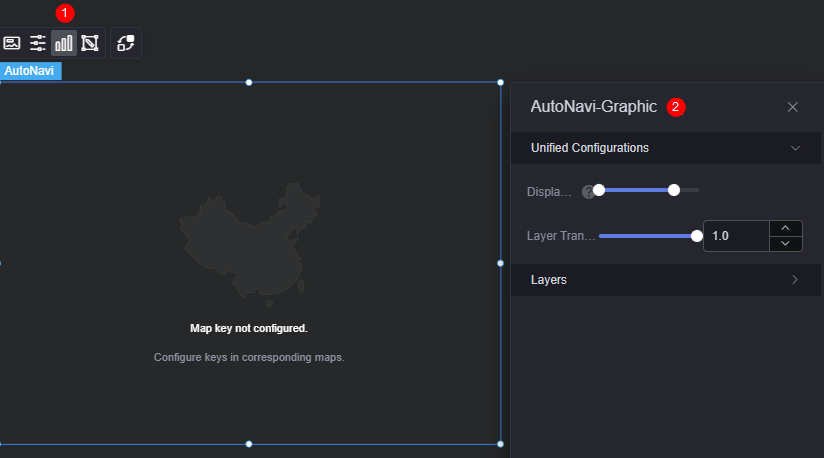

Graphic
A graphic is a specific graphical expression element that visualizes data in a widget, for example, a slice in a pie chart, a bar in a bar chart, a line or a kink point in a line chart.
Figure 8 Amap
  • Unified configuration
    • Display range: You can set the display range of layers in a unified manner. When the map zoom level is within the range, the corresponding layer is displayed.
    • Layer transparency: You can set the transparency of layers in a unified manner.

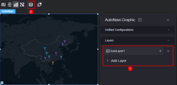

  • Layer: Click the add button to add a layer. You can create layers for icons, labels, bar charts, flying lines, basic heat maps, or region heat maps.
    Figure 9 New layer
