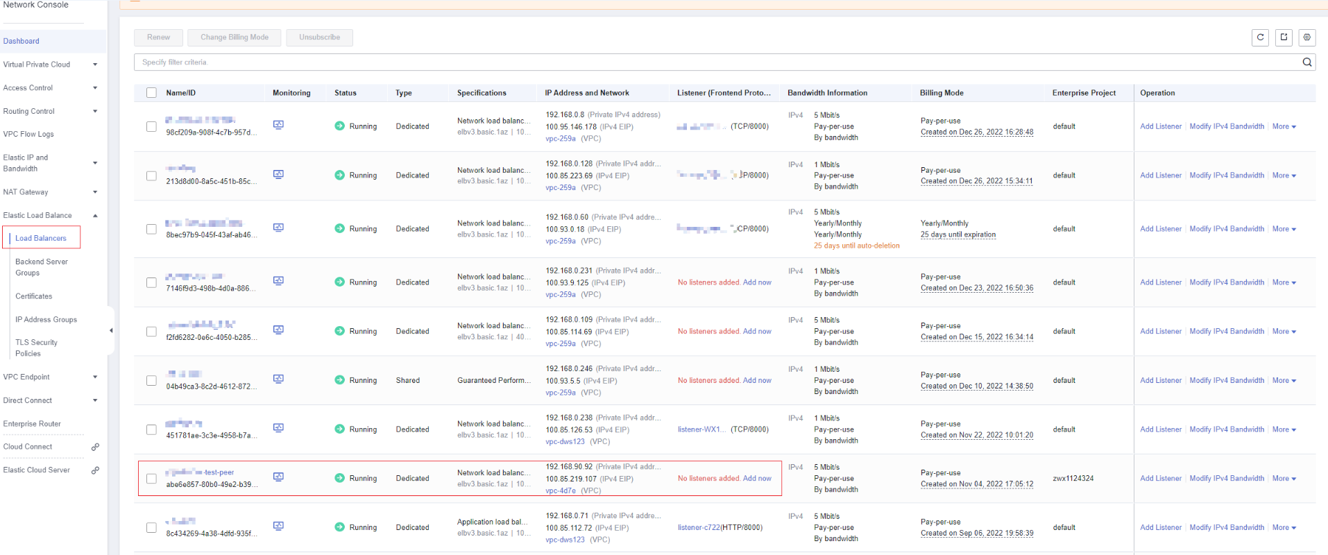

  4. In the Connection area, click Bind Load Balancer and select a load balancer. If there is no load balancer, create one on the ELB console. Then go back to the DWS console, refresh the Cluster Information page, and bind the created load balancer to the cluster.

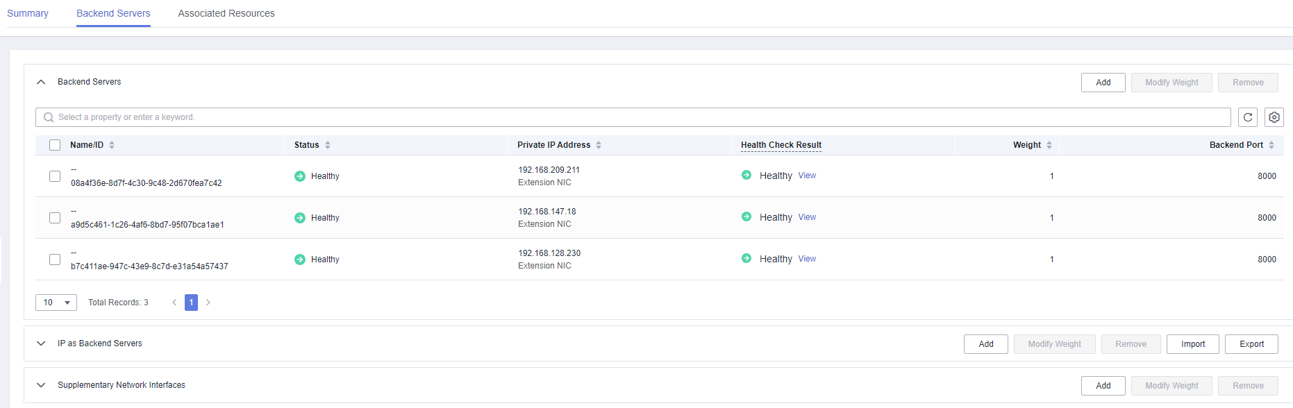

  6. Log in to the ELB management console, click the name of the associated ELB, switch to the Backend Server Groups tab, and check whether the cluster CNs are associated with the load balancer. If the health check result indicates that the backend nodes are deleted, ignore the problem. For details, see Viewing a Backend Server Group.

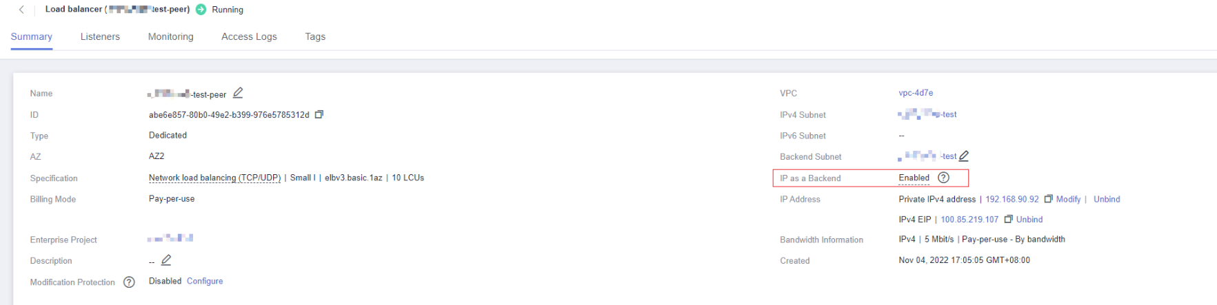

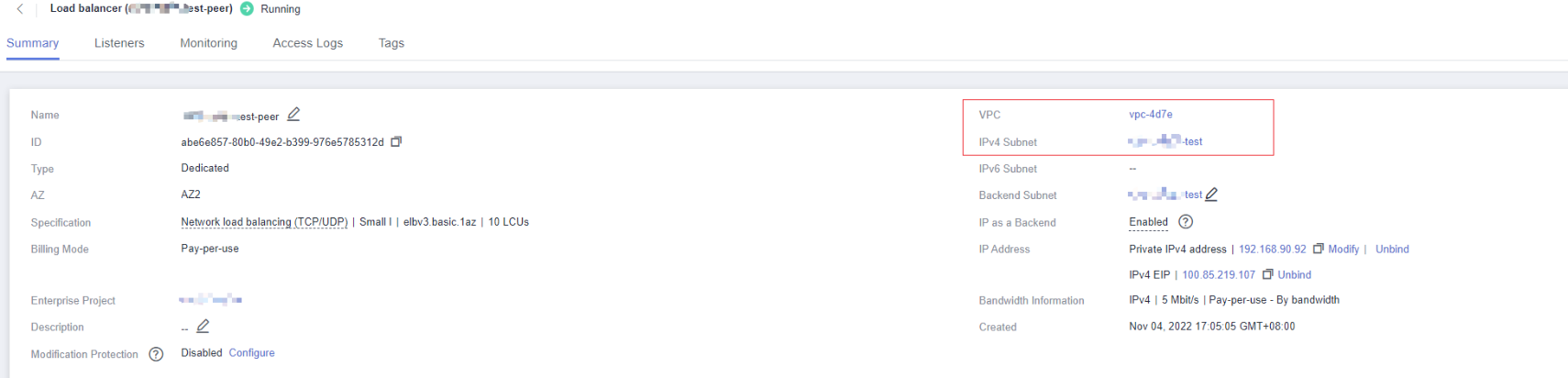

  1. Log in to the ELB console.
  2. In the ELB list, click the name of a dedicated ELB to go to its details page.
  3. On the Summary page, enable IP as a Backend, confirm the information, and click OK.
  4. Check VPC and IPv4 Subnet, which will be used for configuring routes.

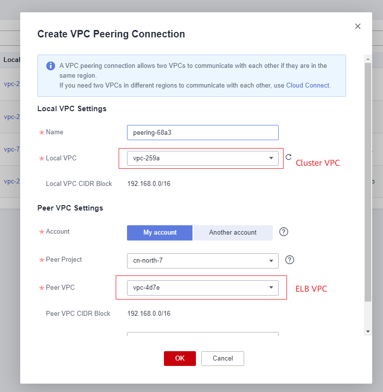

  4. In the Service List, choose Virtual Private Cloud. In the navigation pane on the left, choose My VPCs. Locate the VPC for which you want to create a VPC peering connection.
  5. Choose VPC Peering Connections. In the upper right corner of the page, click Create VPC Peering Connection.
  6. On the displayed page, set Local VPC to the cluster VPC, and set Peer VPC to the VPC of the ELB. Confirm the settings and click OK.

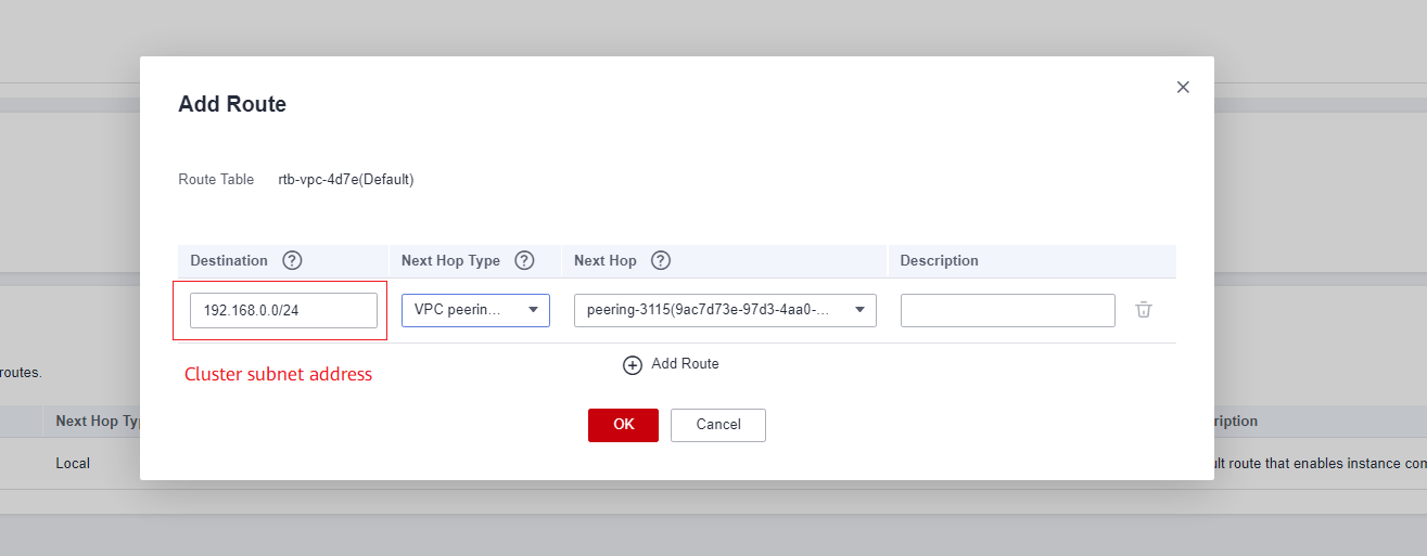

  7. Click Add Route to add the route information.

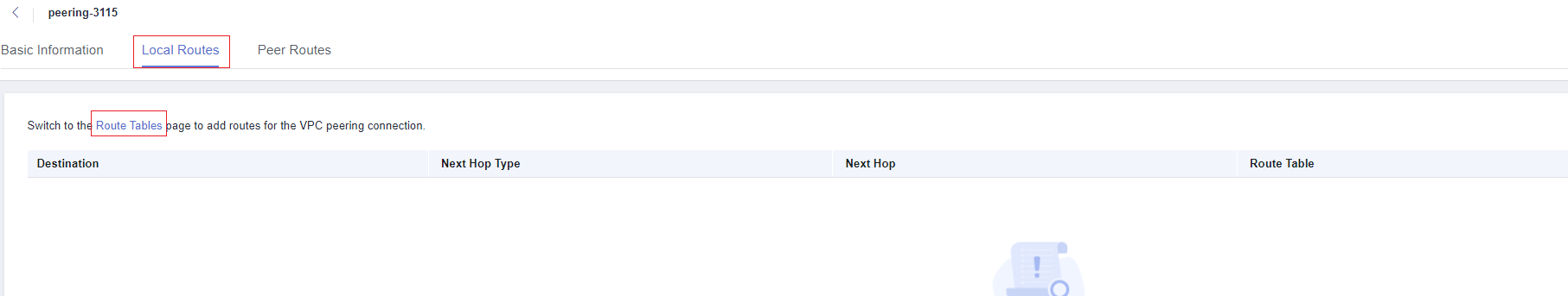

  8. Click the name of the created VPC peering connection. On the displayed page, click the Local Routes tab, click Route Tables, and add the route table of the cluster VPC.
  9. In the local route table, set Destination to the subnet CIDR block of the ELB VPC, set Next Hop Type to VPC peering connection, and set Next Hop to the created VPC peering connection. Click OK.

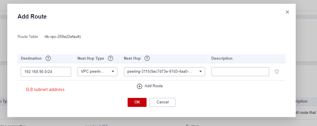

  10. Go to the basic information page of the created VPC peering connection, click the Peer Routes tab, click Route Tables, and add the route table of the ELB VPC.
  11. In the peer route table, set Destination to the subnet CIDR block of the cluster VPC, set Next Hop Type to VPC peering connection, and set Next Hop to the created VPC peering connection. Click OK.

  6. Log in to the ELB management console, click the name of the dissociated ELB, switch to the Backend Server Groups tab, and check whether the cluster CNs are deleted.
