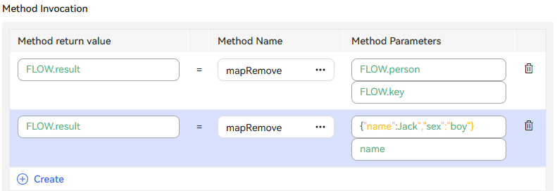

mapRemove()
Deletes a key-value pair from a map.
The return object is the original value of the key in the map or null if the map does not contain the key. There are two parameters: map to be processed and key (only the string type is supported).
Example:
If a flow variable FLOW.person is of the object type and the value is {"name":"Jack","sex":"boy"}, you can invoke this method in the method invocation area to delete a key-value pair from the map. You can cache the deletion result to a variable (FLOW.result). After the deletion is successful, the new value of FLOW.person is stored in the cache until the flow ends or the value is changed again. You can assign a value to the method parameter using a variable or manually.

Example:
If a flow variable FLOW.person is of the object type and the value is {"name":"Jack","sex":"boy"}, you can invoke this method in the method invocation area to obtain the total number of keys in the map. After this method is invoked, you can cache the obtained result to any variable (FLOW.result) of the integer type. You can assign a value to the method parameter using a variable.

Figure 1 Percentage function
Figure 2 Method Invocation
