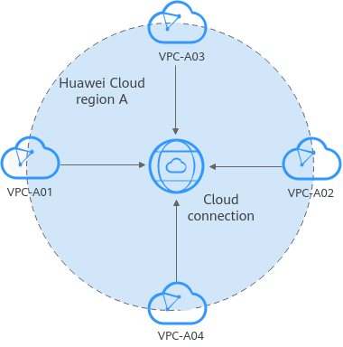

  • Connecting VPCs in the same region to set up a single private network
    By default, VPCs in the same region can communicate with each other after they are loaded to a cloud connection.
    Figure 1 Communication between VPCs in the same region

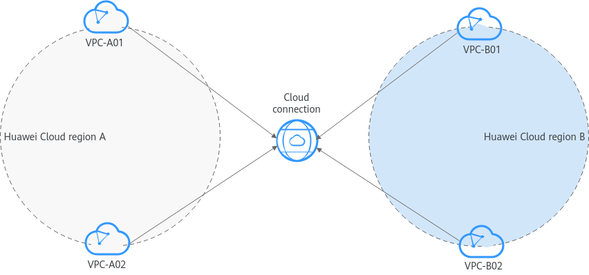

  • Connecting VPCs in different regions to set up a single private network
    A cloud connection helps realize secure and reliable private network communications among VPCs in different regions in addition to improving network topology flexibility.
    Figure 2 Communication between VPCs in different regions

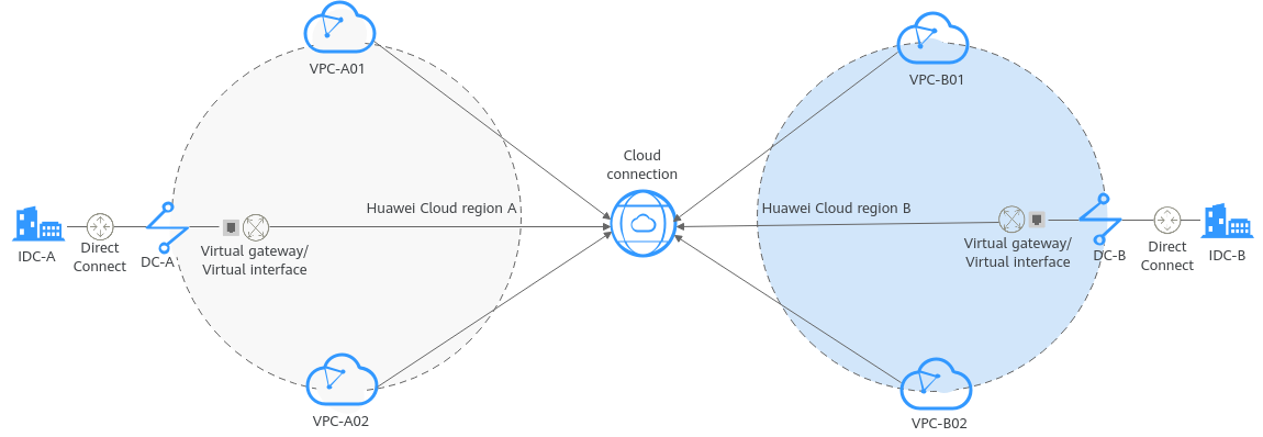

  • Connecting on-premises data centers to VPCs in different regions to set up a hybrid cloud network
    If you want to establish connectivity between multiple on-premises data centers and VPCs in different regions, you can use Direct Connect to connect each data center to the corresponding VPC and then load all the virtual gateways and VPCs to a cloud connection.
    Figure 3 Communication between on-premises data centers and VPCs across regions
