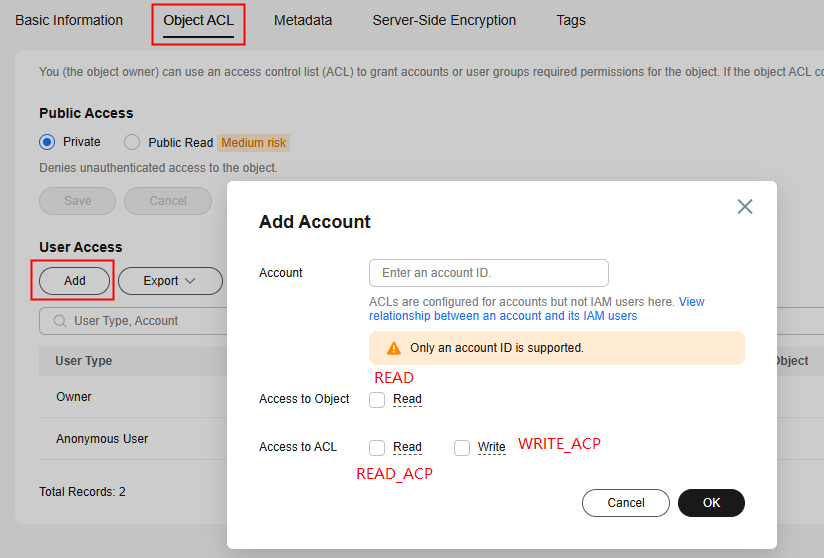

Other accounts
ACLs can be used to grant accounts permissions to access buckets and objects. Once a specific account is granted such permissions, all IAM users under this account have the same permissions as this account.
If you want to grant different permissions to different IAM users under other accounts, you can configure bucket policies.
NOTE:
Users must have both the ACL and IAM permissions to access resources across accounts. For details, see Which Permissions Apply When They Conflict?

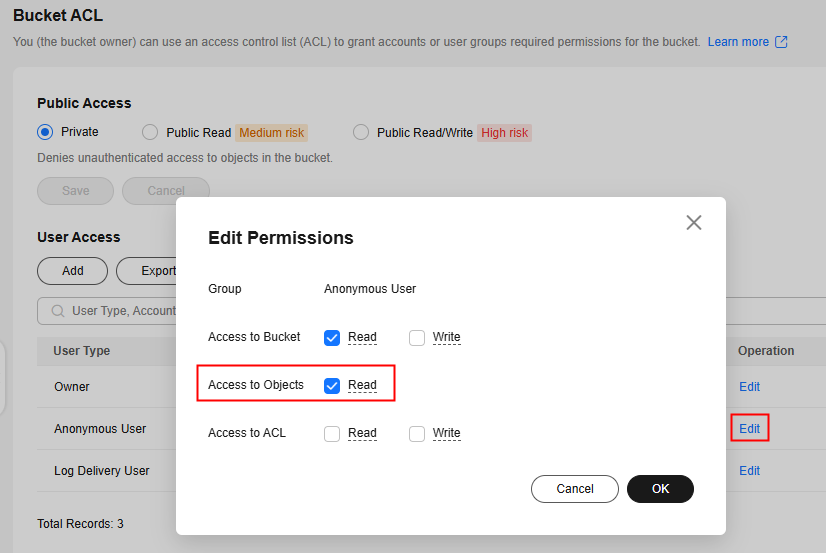

Table 3 and Table 4 list the permissions that can be configured in a bucket ACL.
Table 3 Bucket access permissions
Permission
Description
Read
A user with this permission can obtain the list of objects in a bucket and the metadata of the bucket.
Write
A user with this permission can upload objects to a bucket, and can delete and overwrite existing objects in the bucket.
Object read
Objects in a bucket inherit the read permission configured for the bucket. An authorized user can obtain the content and metadata of objects.
Table 4 Bucket ACL access permissions
Permission
Description
Read
A user with this permission can read the bucket ACL.
Write
A user with this permission can update the bucket ACL.

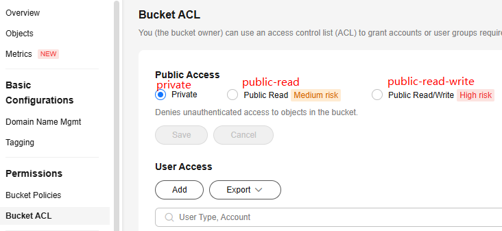

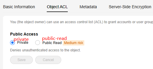

OBS provides six types of predefined ACLs, as described in Table 7. A predefined ACL is applied to all users.
Table 7 OBS-predefined ACLs
Predefined ACL
Description
private
A bucket or an object can only be accessed by its owner.
By default, the ACL is set to private.
public-read
If this permission is set for a bucket, anyone can obtain its object list, multipart tasks, and metadata.
If this permission is set for an object, anyone can obtain the content and metadata of the object.
public-read-write
If this permission is set for a bucket, anyone can obtain its object list, multipart upload tasks, and metadata, and can upload, delete objects, initiate multipart uploads, upload, assemble, and copy parts, and cancel multipart uploads.
If this permission is set for an object, anyone can obtain the content and metadata of the object. This permission works the same as public-read.
public-read-delivered
If this permission is set for a bucket, anyone can obtain its object list, multipart upload tasks, and metadata. Compared with public-read, this permission also allows access to the content and metadata of the objects in the bucket.
This permission does not apply to objects.
public-read-write-delivered
If this permission is set for a bucket, anyone can obtain its object list, multipart upload tasks, and metadata, and can upload, delete objects, initiate multipart uploads, upload, assemble, and copy parts, and cancel multipart uploads. Compared with public-read-write, this permission also allows access to the content and metadata of the objects in the bucket.
bucket-owner-full-control
Setting this permission for an object will enable the bucket owner to have full control over the object.
By default, if you upload an object to a bucket of any other user, the bucket owner does not have the access to your object. After you grant the bucket-owner-full-control permission to the bucket owner, the bucket owner can have full control over your object.

You can customize ACLs to grant permissions to specified accounts or anonymous users. Table 8 lists the permissions that can be configured in bucket or object ACLs.
Table 8 Permissions that can be configured in bucket or object ACLs
Permission
When Granted for a Bucket
When Granted for an Object
API Header
READ
A user with this permission can obtain the list of objects in the bucket and the metadata of the bucket.
A user with this permission can obtain the content and metadata of the object.
x-obs-grant-read
WRITE
A user with this permission can upload objects to the bucket, and can delete and overwrite existing objects in the bucket.
Not supported
x-obs-grant-write
READ_ACP
A user with this permission can read the object ACL.
x-obs-grant-read-acp
WRITE_ACP
A user with this permission can update the object ACL.
x-obs-grant-write-acp
FULL_CONTROL
A user with this permission has the READ, WRITE, READ_ACP, and WRITE_ACP permissions.
A user with this permission has the READ, READ_ACP, and WRITE_ACP permissions for the object.
x-obs-grant-full-control
