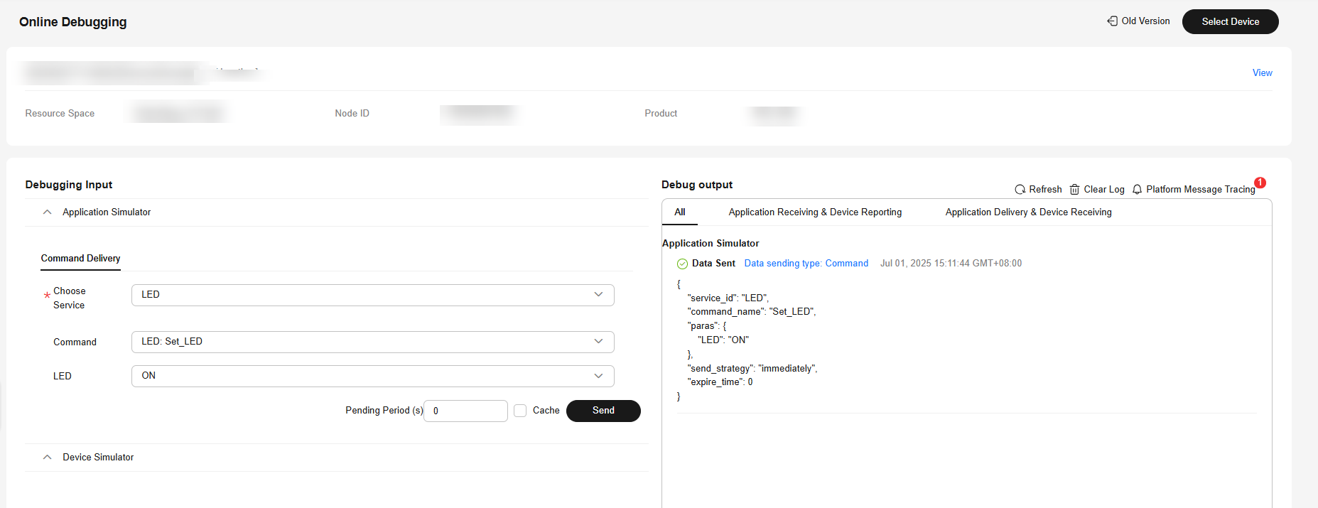

Delivering a Command
  1. Log in to the IoTDA console. Click the target product to go to its details page.
  2. On the Online Debugging tab page, click the target device to access the debugging page.
  3. After setting the command parameters, click Send.
    Figure 11 Command delivery debugging - SmokeDetector
  4. The light on the BearPi board is on. Deliver the OFF command. The light is turned off.
This is the end-to-end development of a smart street light by using the NB-IoT BearPi development board.
