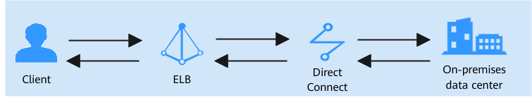

Solution Architecture
Figure 1 Distributing traffic to an on-premises server
In this practice, a Direct Connect connection is required to connect on-premises servers to a VPC and a dedicated load balancer is required to route requests to on-premises servers.
  • Dedicated load balancer ELB-Test is running in a VPC named VPC-Test-01 (172.16.0.0/12).
  • An on-premises server (IDC-IP-Test) is deployed in the on-premises data center.
  • The IP address of IDC-IP-Test is added to the backend server group of ELB-Test.

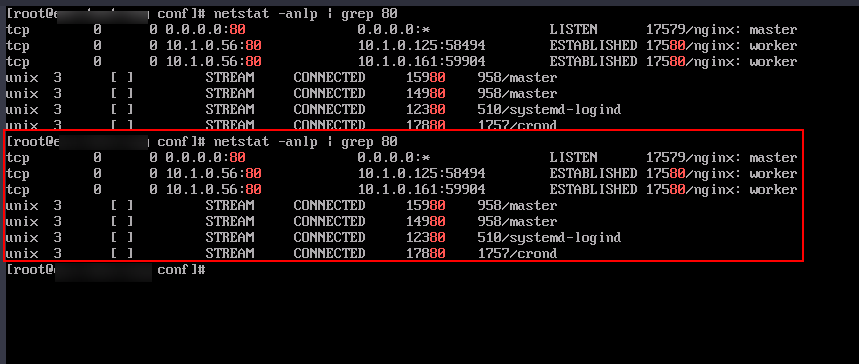

Step 2: Deploy a Service on the On-Premises Server
Deploy Nginx on the on-premises server IDC-IP-Test to verify network connectivity.
Figure 2 Nginx deployed on the on-premises server

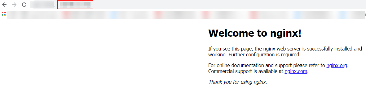

  2. Use a browser to verify the network connectivity.
    Use a browser to access http://<EIP-of-the-load-balancer>. If the following page is displayed, the request is forwarded by the load balancer to the on-premises server.
    Figure 3 The Nginx default welcome page when accessed using a browser
