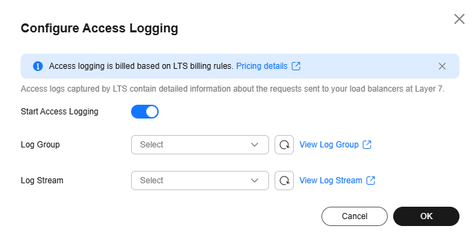

Step 3: Configure Access Logging
  1. Go to the load balancer list page.
  2. On the Load Balancers tab, locate the load balancer and click its name.
  3. Under Access Logs, click Configure Access Logging.
  4. Enable access logging and select the log group and log stream you have created.
    Figure 2 Configuring access logging
  5. Click OK.

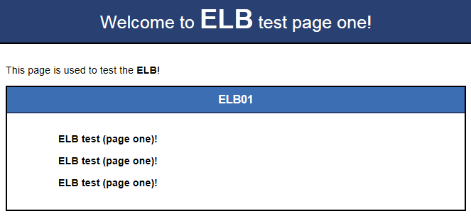

Step 4: Access the Load Balancer Through Its EIP
Enter the EIP bound to the load balancer in the address box of your browser to access the load balancer. If the page shown in Figure 3 is displayed, the request is forwarded to ECS01, and the application is successfully deployed.
Figure 3 Nginx successfully deployed on ECS01

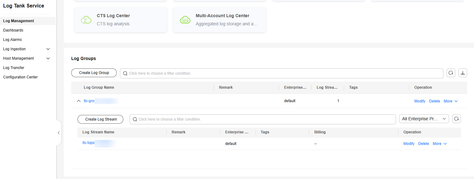

  1. On the Access Logs tab of the load balancer, click View Log Details. The log management page of the LTS console is displayed.
    Figure 4 Viewing the log group

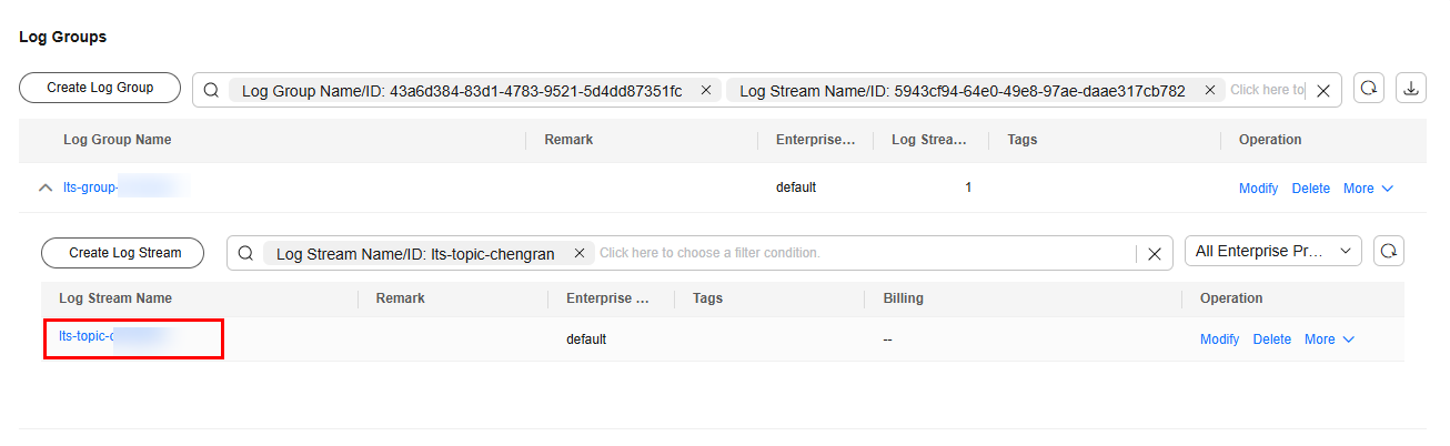

  2. On the Log Groups page, click the log stream name to go to its details page.
    Figure 5 Viewing the log stream

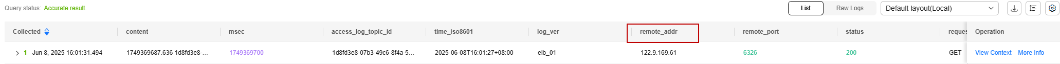

  3. On the log stream details page, check the client IP address in the log list.
    1. If the client directly accesses the load balancer, the IP address in the remote_addr field indicates the client IP address.
    2. If the client accesses the load balancer through a proxy server, the first IP address in the http_x_forwarded_for field indicates the client IP address.

    Table 2 Fields in the access log
    Field
    Description
    Value Description
    remote_addr: remote_port
    IP address and port number of the client.
    Records the IP address and port of the client.
    http_x_forwarded_for in the request header received by the load balancer, indicating the request is sent through a proxy server.
    Records all the IP addresses along the path through which the request is sent. The first IP address is the client IP address.
    Figure 6 Viewing the client IP address
