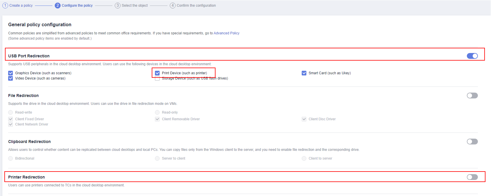

Configuring the USB Port Redirection Policy
If the administrator configures the USB Port Redirection policy for the desktop, users can use the connected printer to print files using the desktop. However, the connected printer cannot be used for printing using the terminal device.
  1. Log in to the console.
  2. Click Policies.
    The Policies page is displayed.
  3. Click Create Policy.
    The page for creating a policy is displayed.
    Figure 1 Creating a policy

  7. Set USB Port Redirection to and select Print Device (such as printer), as shown in Figure 2.
  8. Set Printer Redirection to , as shown in Figure 2.

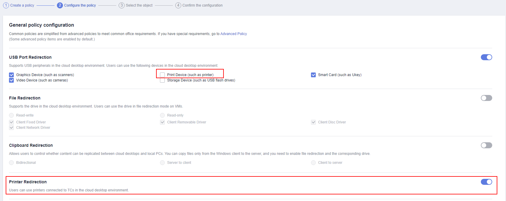

Configuring the Printer Redirection Policy
If the administrator configures the Printer Redirection policy for the desktop, users can use the connected printer to print files using both the desktop and the terminal device.
  2. Click Policies.
    Figure 4 Creating a policy
  4. Set the policy name and enter the description.
    • The policy name can contain up to 55 characters in digits, letters, and underscores (_), for example, Printer_Device_Redirection0Printer2workspace.
    • The description can contain up to 255 characters, for example, Use a local printer with the printer redirection policy.
  5. Creation Mode: Select Create without template.
  6. Click Next: Configure policies.
    The page for general policy configuration is displayed.
  7. Deselect Print Device (such as printer) under USB Port Redirection, as shown in Figure 5.
  8. Set Printer Redirection to , as shown in Figure 5.
    Figure 5 Configuring policy parameters

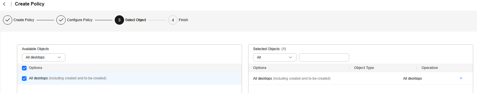

  9. Click Next: Select Object.
  10. Select an object as required.
    For example, if you select All desktops, the policy applies to all desktops in the current project.
    Figure 6 Selecting an object
