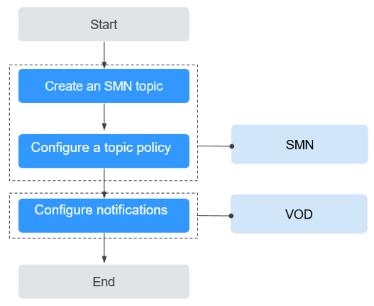

Process Flow
Figure 1 shows the process of configuring notifications.
Figure 1 Process of configuring notifications
  1. Create an SMN Topic on the SMN console.
  2. Configure a topic policy to authorize VOD to publish messages to the topic.
  3. Configure notifications on the VOD console so that you can receive notifications during operations such as transcoding, snapshot capturing, and review.

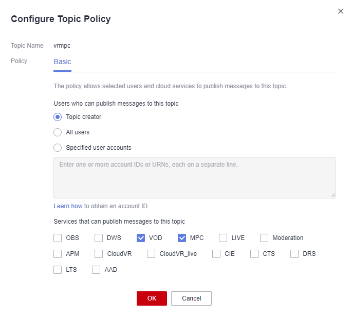

Configuring a Topic Policy
  1. Go to the SMN console.
  2. In the navigation pane on the left, choose Topic Management > Topics.
  3. Choose More > Configure Topic Policy in the Operation column of the created topic.
    On the displayed page, configure a topic policy in basic mode. The basic mode simply specifies which users or cloud services have permissions to publish messages to the topic. For details, see Table 3.
    Table 3 Description for configuring a topic policy in basic mode
    Item
    Settings
    Description
    Users who can publish messages to this topic
    Topic creator
    Only users under the same account as the topic creator have permissions to publish messages to this topic.
    All users
    All users have permission to publish messages to the topic.
    Specified user accounts
    Only specified users have permission to publish messages to the topic.
    Users are specified in the format urn:csp:iam::domainId:root,
    in which domainId indicates the account ID of a user. Every two users are separated with a comma (,). SMN does not limit the number of users you can specify, but the total length of a topic policy cannot exceed 30 KB.
    NOTE:
    • Enter the account ID of the user and click OK. Other information is automatically supplemented by the system.
    • To obtain a user's account ID, log in to the SMN console, hover the mouse over the username in the upper right corner, and choose My Credentials from the drop-down list.
    Services that can publish messages to this topic
    For example, VOD.
    The services that can publish messages to a topic vary depending on regions.
    Selecting VOD grants it permissions for this topic.
