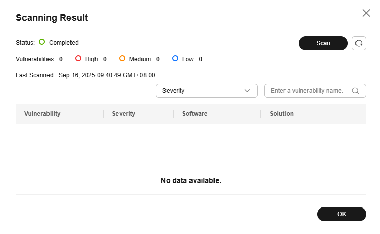

- Click Scan and wait for the result.
- Vulnerability Name: the name of the vulnerability found on the image
- Severity Level: the severity of the vulnerability. You can determine whether immediate action is required based on the severity level.
- Software Information: version information about the software affected by the vulnerability
- Solution: solution to the vulnerability. Click the link in the Solution column to view the solution.
