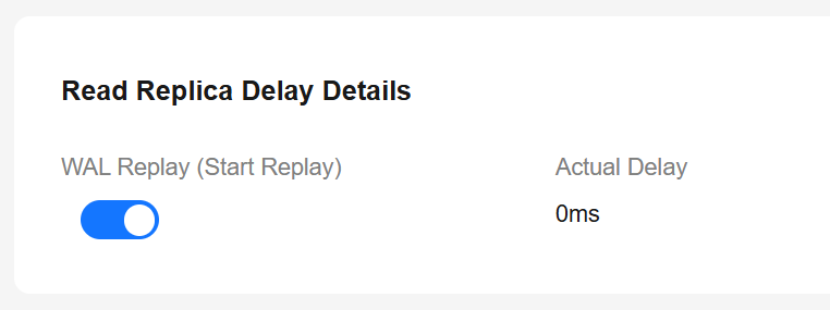

in front of the target DB instance and then click the name of the target read replica. - Go to the Read Replica Delay page or refresh the page. The read replica delay details at the current time are displayed.
Figure 1 Read Replica Delay Details
Table 1 Read replica delay details Parameter
Description
WAL Replay
The WAL replay status of the read replica. You can pause or resume WAL replay by toggling the switch.
- Toggling on the switch: WAL replay starts.
- Toggling off the switch: WAL replay pauses.
Actual Delay
The actual delay for WAL replay on the read replica during page loading or refreshing, in ms.
The value of this parameter is slightly different from that of Custom Delay. For example, if there are no data writes to the primary instance and no WAL logs are synchronized, the actual delay is 0 ms.

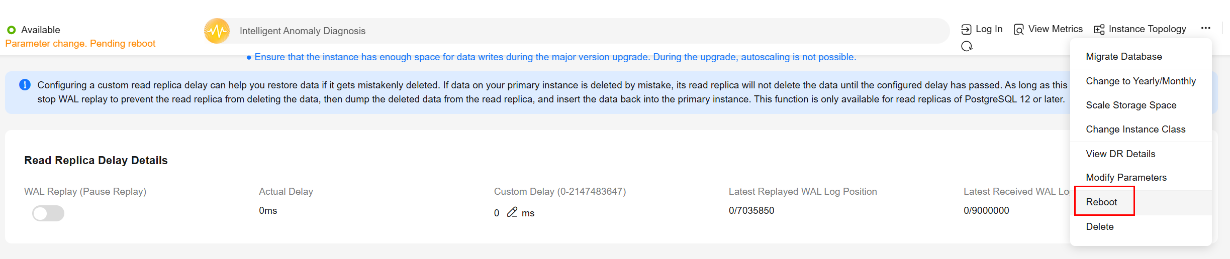

- Click Reboot to replay WAL logs to the specified time.
Figure 4 Rebooting the read replica

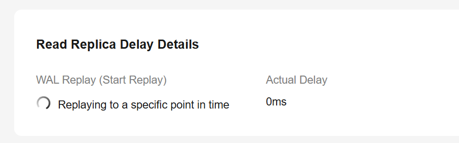

- Check the replay status.
Figure 5 Replaying

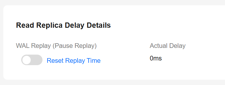

- To restore the replay, reset the replay time and reboot the read replica.

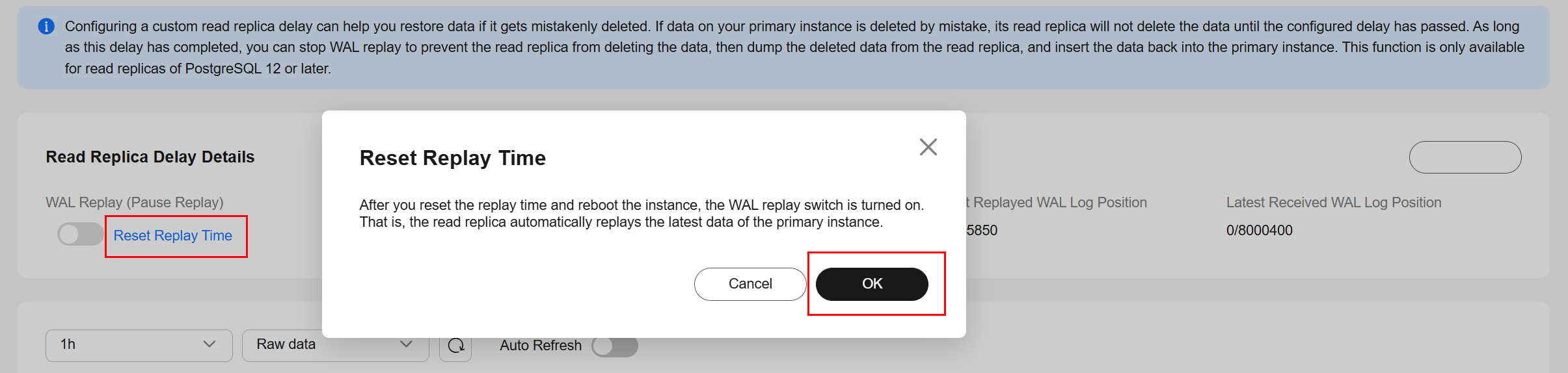

- Click Reset Replay Time. In the displayed dialog box, click OK.
After the read replica is rebooted, there will still be a replay delay. The delay depends on the value of recovery_min_apply_delay. If you want to immediately replay the WAL logs to the specified time, set this parameter to 0.
Figure 7 Resetting the replay time

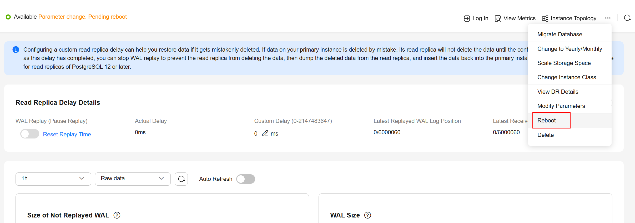

- Click Reboot.
Figure 8 Rebooting the read replica

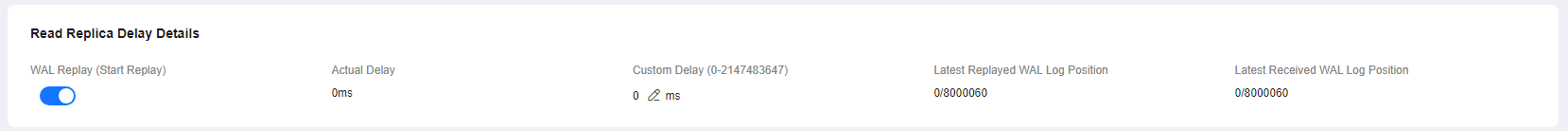

- Check whether the replay status becomes normal.
Figure 9 Normal replay
