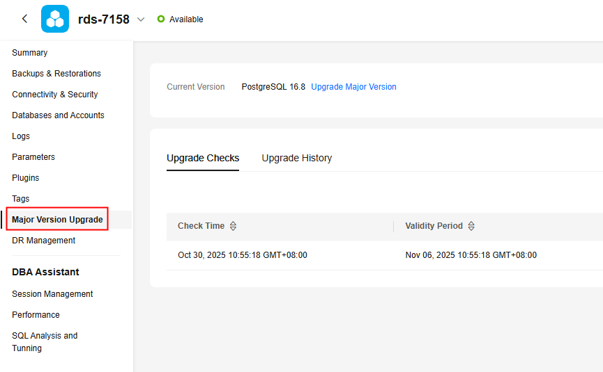

  3. On the Instances page, click the instance name to go to the Summary page.
  4. In the navigation pane, choose Major Version Upgrade.
    If the Major Version Upgrade tab is not displayed, submit a service ticket to apply for required permissions.

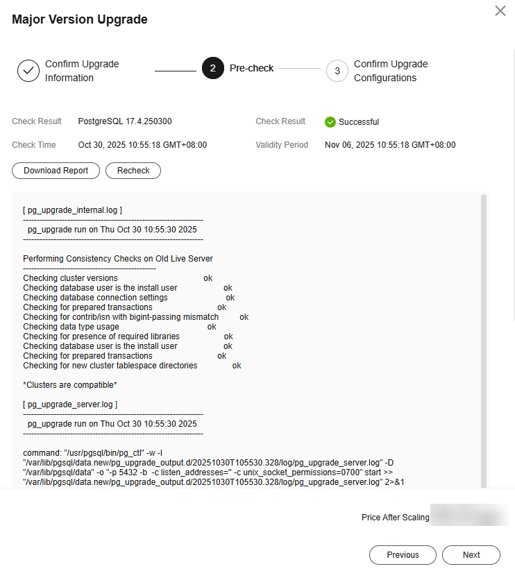

  6. On the pre-check page, start a pre-check. It takes several minutes to complete the check.
    Figure 3 Pre-check
    • If any extensions are installed on the instance after a successful upgrade check, an upgrade may fail due to compatibility issues. If this happens, perform a check again. For details, see Extensions Unsupported for Major Version Upgrades.
    • If the upgrade check fails, you can view the check report by clicking View Report on the Upgrade Checks tab page and rectify the incompatibility based on the report.

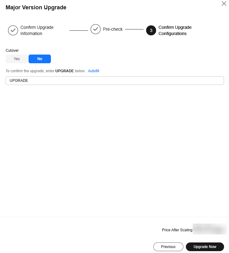

  7. After the check is passed, choose a parameter template, select No for Cutover, click Autofill to fill UPGRADE, and click Upgrade Now.
    Figure 4 Upgrade without cutover

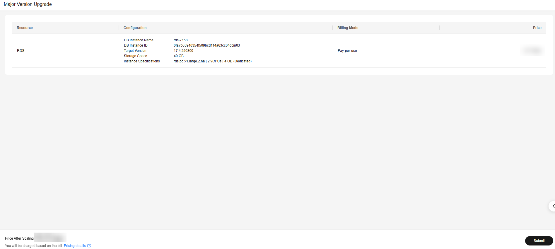

  8. Confirm the upgrade information and click Submit.
    Figure 5 Confirming upgrade information

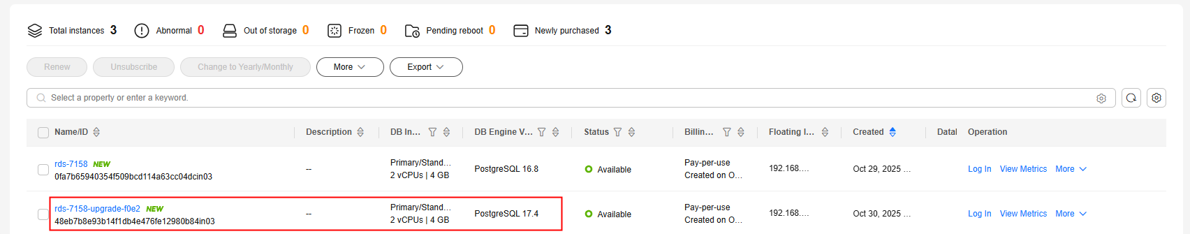

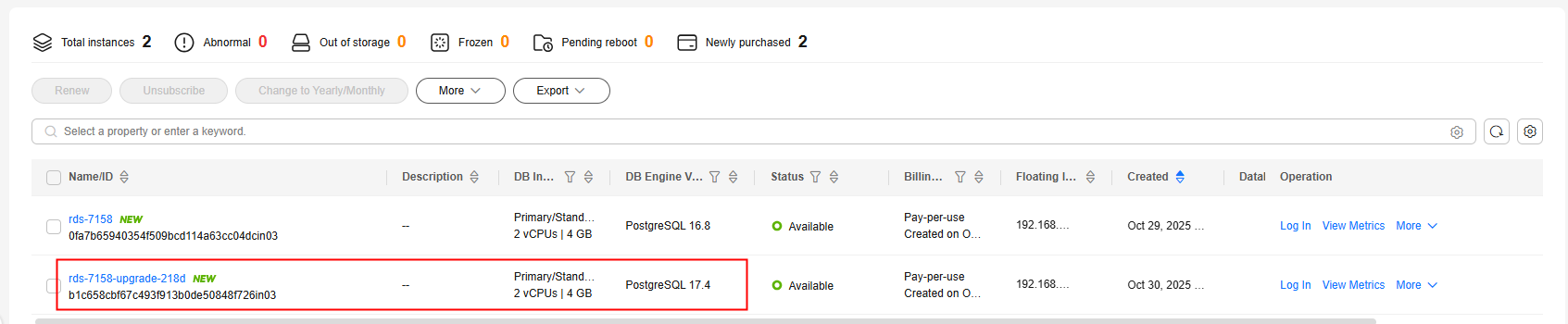

  9. After the upgrade is complete, check for the new instance of the target version. You can connect to the new instance to test workload compatibility.
    Figure 6 Checking the upgrade results

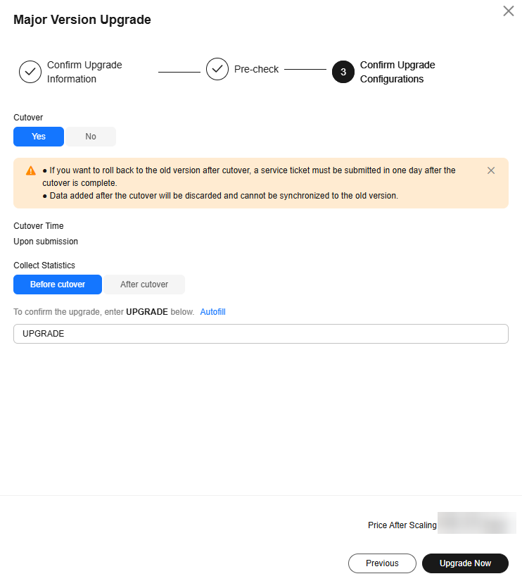

  7. After the check is passed, choose a parameter template, select Yes for Cutover, specify Collect Statistics, click Autofill to fill UPGRADE, and click Upgrade Now.
    Figure 10 Upgrade with cutover
    During a major version upgrade, optimizer statistics are not automatically synchronized. Statistics need to be collected after the upgrade is complete.
    • If you choose to collect them before cutover, workload stability is ensured. If your instance has too much data, the upgrade may take a longer time.
    • If you choose to collect them after cutover, faster upgrade is ensured. After the upgrade, accessing tables for which no statistics have been generated may cause inaccurate execution plans and even instance breakdowns during peak hours.

  9. After the upgrade is complete, check for the new instance of the target version. Your workloads are automatically switched over to the new instance.
    Figure 12 Checking the upgrade results
