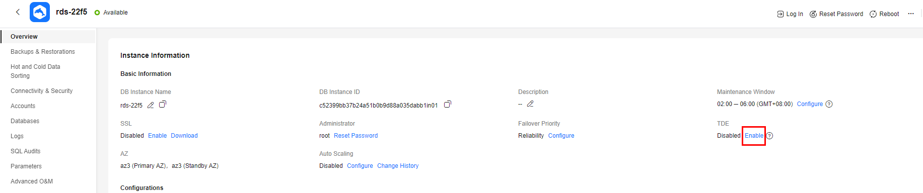

  3. On the Instances page, click the target instance name to go to the Overview page.

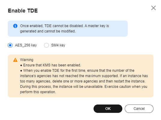

  4. Under TDE, click Enable.
    Figure 1 Enabling instance-level TDE
  5. In the displayed dialog box, click OK.
    Figure 2 Enabling TDE

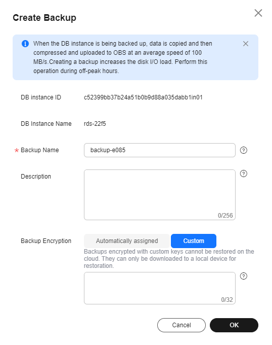

    • Method 2: Use the transition key --transition-key.
      1. When creating a manual backup on the console, enter a custom key string as prompted to re-encrypt the data. For details, see Creating a Manual Backup.
        Figure 3 Custom encryption
