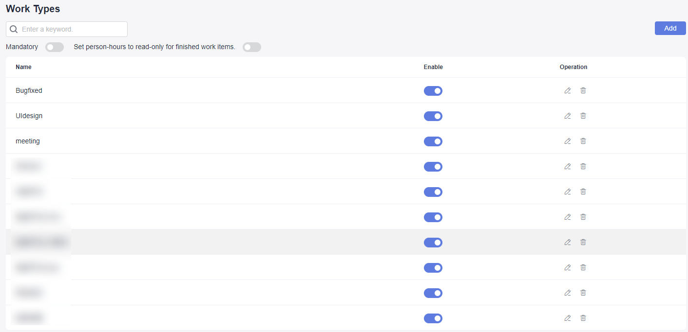

    Figure 1 Work Types page
  4. Click Add to add a work type by referring to the following table. A maximum of 500 work types can be added.

  7. On the page for editing a work item, set the person-hours required for a specific work type.
