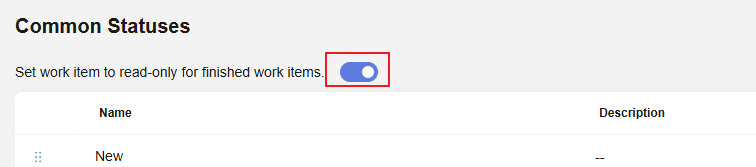

  3. In the navigation pane, choose Common Statuses. Click Add Status and add work item statuses (for example, CommonStatus 1) by referring to Table 1.
    Table 1 Status parameters
    Parameter
    Description
    Status
    Status name. The value can contain 2 to 15 characters, including letters, digits, underscores (_), and hyphens (-).
    Status Category
    Select a value from the drop-down list, including To do, Doing, and Done.
    Description
    The status description contains a maximum of 100 characters.
    • The added status is displayed in the status list, including the name, description, category, and usage.
    • Common statuses can be deleted.
