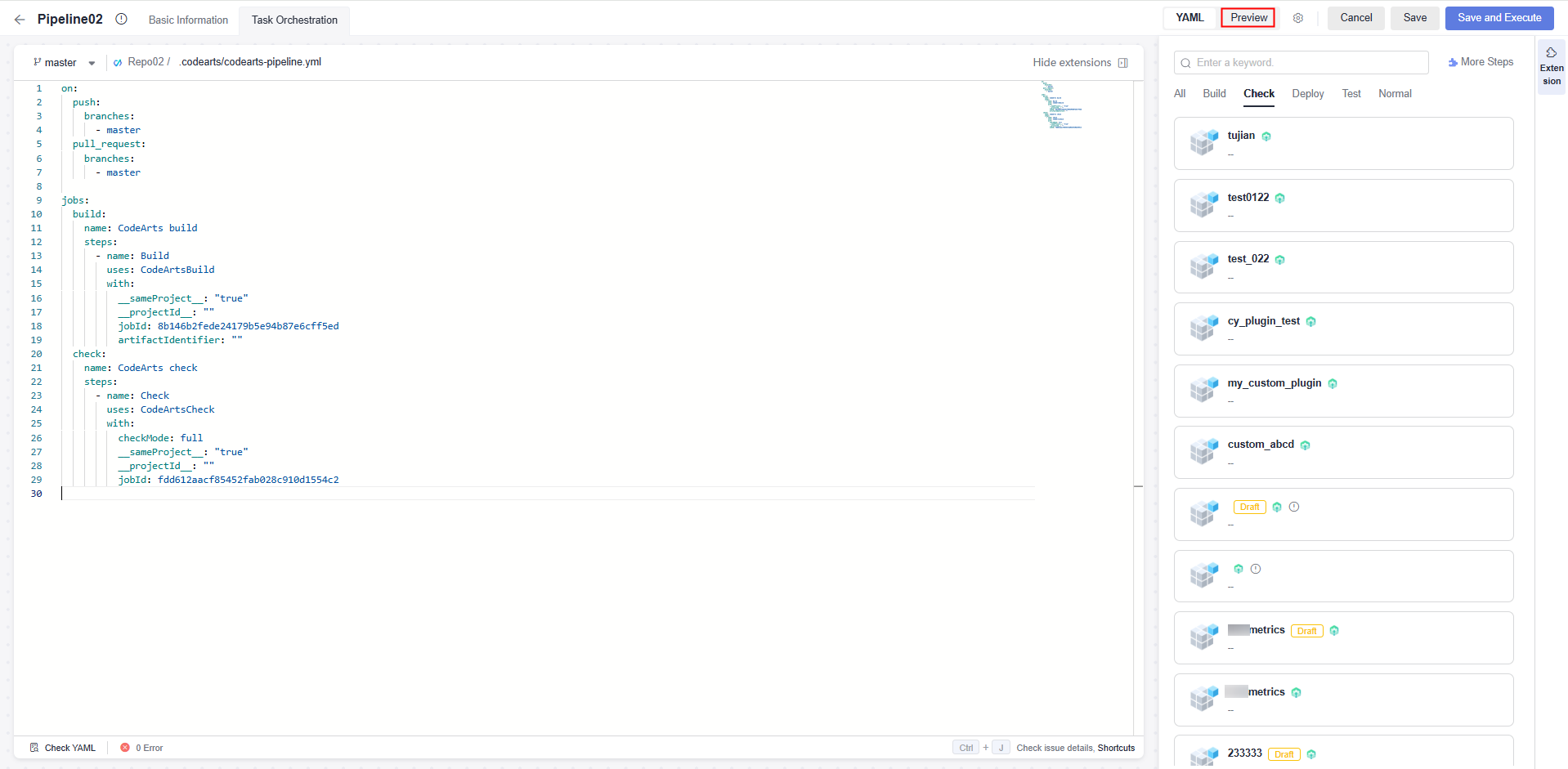

  3. After configuring the basic information, click OK. The Task Orchestration page is displayed.
    • You can edit the YAML file on the left. For details, see YAML Syntax. The following uses serial tasks of build and code check as an example.
    • You can add extensions to the YAML file from the extension list displayed on the right.
    You can verify YAML syntax during orchestration. Click Preview to switch to the graphical user interface.
    Figure 1 Task orchestration

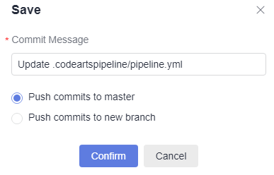

  4. After orchestration, click Save, enter the commits message, and push commits.
    • Push commits to the existing branch: If you create the pipeline with a new YAML file, commits will be pushed to the default branch. If you create a pipeline with an existing YAML file, commits will be pushed to the branch where the YAML file resides.
    • Push commits to a new branch: Commits will be pushed to a new branch. If you selected Create merge request, a merge request will be created for the new branch and the existing branch.
  5. Click Confirm. A message is displayed, indicating that the pipeline is created.
