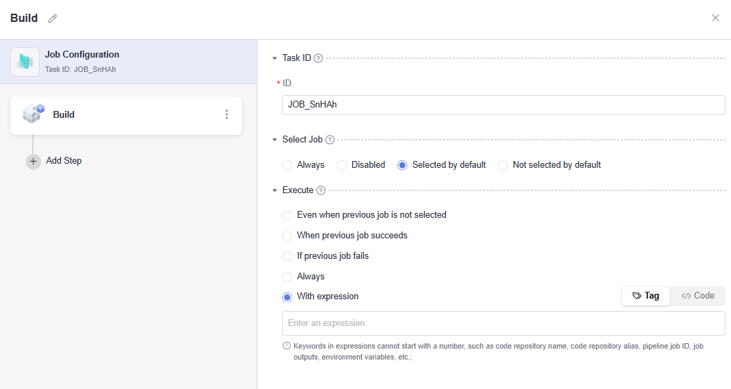

  1. Create a pipeline.
  2. Add stage jobs or edit existing jobs.
  3. Click Job Configuration and set Execute to With expression to configure the expression for job execution. For a new stage and job, add an extension first and then click Job Configuration.
    Figure 1 Expressions
    Example:
    The following expression shows that a job runs only when the running branch of the specified code source is master.
    ${{ sources.my_repo.target_branch == 'master' }}
