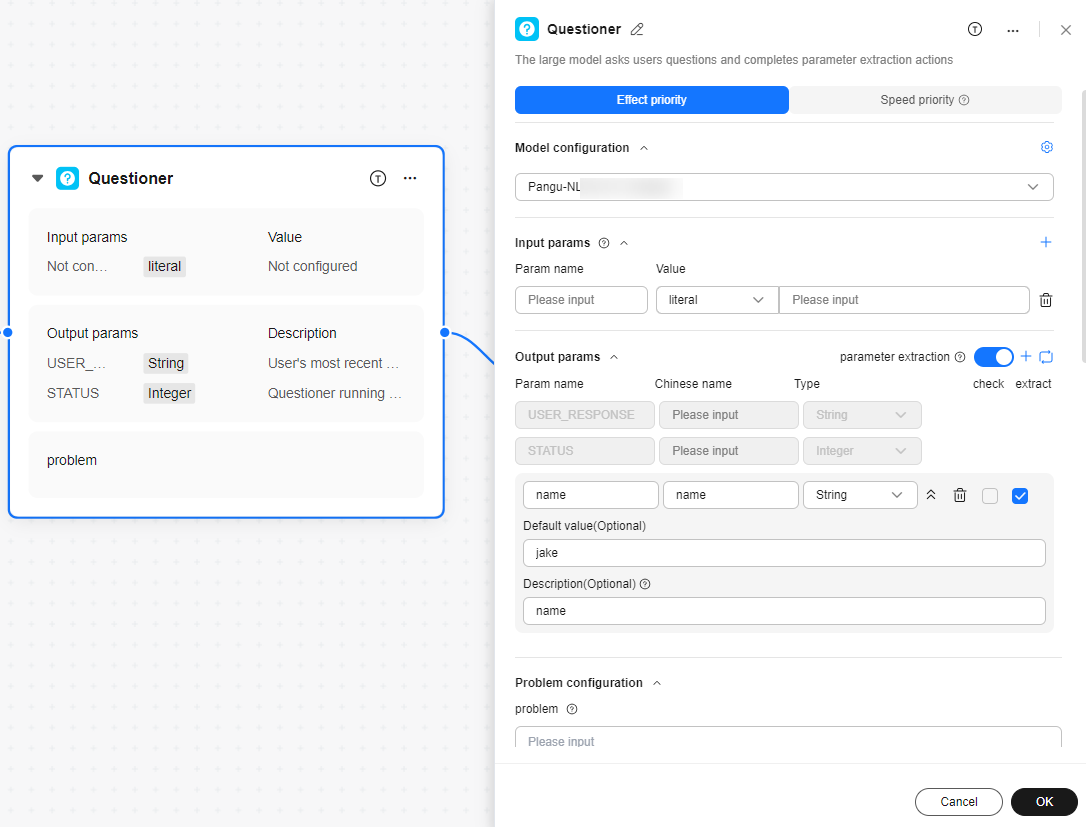

  1. Click Add Node at the bottom of the canvas, drag the Questioner node from the node drawer to the canvas, and click the node to open the node configuration page.
  2. Configure the Questioner node by referring to Table 1.

    Figure 1 Questioner node configuration example
