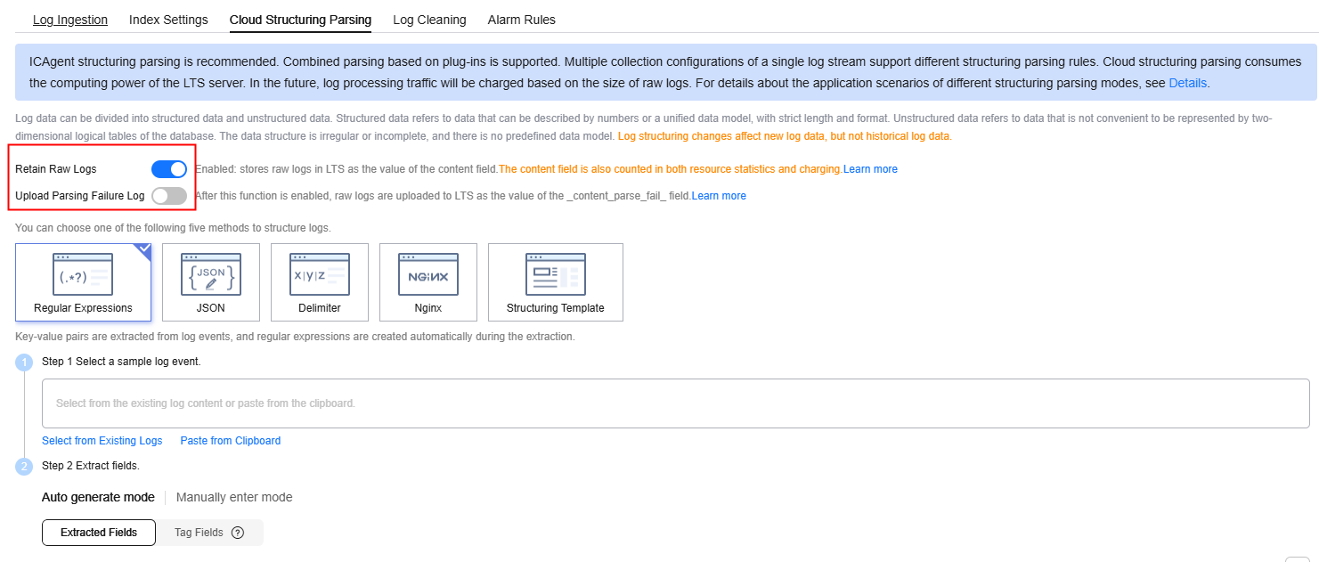

  3. On the Log Search tab page, click Log Settings in the upper right corner. On the displayed page, click the Cloud Structuring Parsing tab to configure log structuring.
    • If Retain Raw Logs is enabled, raw logs will be stored in LTS as the value of the content field. The content field is also counted in both resource statistics and charging.
    • If Upload Parsing Failure Log is enabled, raw logs will be uploaded to LTS as the value of the _content_parse_fail_ field.
    • The following describes how logs are reported when Retain Raw Logs and Upload Parsing Failure Log are enabled or disabled.
      Figure 1 Cloud structuring parsing
      Table 1 Log reporting description
      Parameter
      Description
      • Retain Raw Logs enabled
      • Upload Parsing Failure Log enabled
      • Parsing succeeded: The parsed log and the raw log's content field are reported.
      • Parsing failed: To avoid redundancy, only the raw log's content field is reported. The _content_parse_fail_ field is not reported.
      • Upload Parsing Failure Log disabled
      • Parsing failed: The raw log's content field is reported.
      • Retain Raw Logs disabled
      • Parsing succeeded: The parsed log is reported.
      • Parsing failed: The _content_parse_fail_ field is reported.
      • Parsing failed: Only the system built-in and label fields are reported.

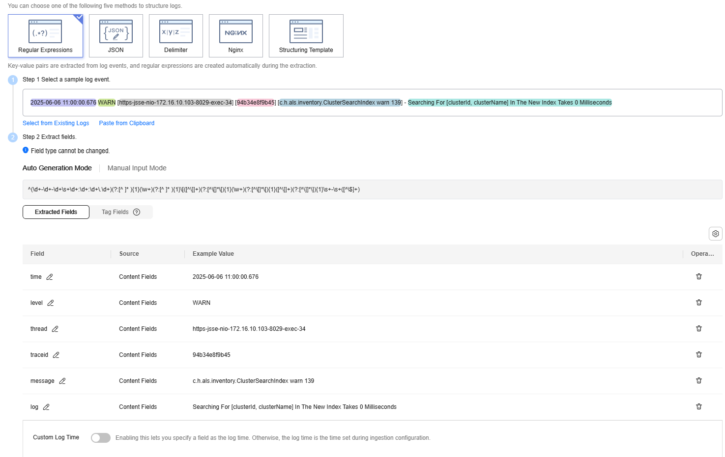

  1. Extract fields. Extracted fields are shown with their example values. You can extract fields in two ways:
    • Auto Generation Mode: Select the log content you want to extract as a field in the sample log event. In the displayed dialog box, set a field name and click Add. A field name can contain only letters, digits, hyphens (-), underscores (_), and periods (.). It cannot start or end with a period, or end with double underscores (__).
      For example, copy and paste the following raw log under Select a sample log event:
      2025-06-06 11:00:00.676 WARN [https-jsse-nio-172.16.10.103-8029-exec-34] [94b34e8f9b45] [c.h.als.inventory.ClusterSearchIndex warn 139] - Searching For [clusterId, clusterName] In The New Index Takes 0 Milliseconds
      Set the field names to time, level, thread, and message based on the raw log example. Figure 2 shows the automatically generated fields.
      Figure 2 Fields automatically generated using regular expressions
    • Manual Input Mode: Enter a regular expression in the text box and click Extract Field. A regular expression may contain multiple capturing groups, which group strings with parentheses. There are three types of capturing groups:
      • (exp): Capturing groups are numbered by counting their opening parentheses from left to right. The numbering starts with 1.
      • (?<name>exp): named capturing group. It captures text that matches exp into the group name. The group name must start with a letter and contain only letters and digits. A group is recalled by group name or number.
      • (?:exp): non-capturing group. It captures text that matches exp, but it is not named or numbered and cannot be recalled.
      • Delimiters split log content into multiple words. Select a portion between two adjacent delimiters as a field. Default delimiters: ,'";=()[]{}@&<>/:\\?\n\t\r and spaces.
      • You can enter up to 5,000 characters for a regular expression. You do not have to name capturing groups when entering the regular expression. When you click Extract Field, those unnamed groups will be named as field1, field2, field3, and so on.
      • Double underscores (__) are not allowed when you manually enter a regular expression. However, you can rename a field under Content Fields to include double underscores.
  2. Specify a field as the log time. For details, see Setting Custom Log Time.
  3. Click Save. The type of extracted fields cannot be changed after the structuring is complete.

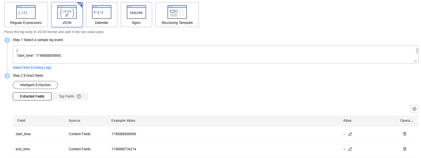

If you choose JSON, JSON logs are split into key-value pairs.
  1. Select a typical log event as the sample. Click Select from Existing Logs, select a log event, or enter a log event in the text box, and click OK. You can select different time ranges to filter logs.
  1. Extract fields. Extract fields from the log event. Extracted fields are shown with their example values.
    Enter the following sample raw log in the text box and click Intelligent Extraction. Figure 3 shows the automatically generated fields.
    "start_time": 1749088800000,
    "end_time": 1749089730214
    Figure 3 Field extraction result of the JSON method
    After fields are extracted, check and edit the fields and save them as a template if needed. For details about rules for configuring structured fields, see Setting Structured Fields.
    • The float data type has 16 digit precision. If a value contains more than 16 valid digits, the extracted content is incorrect, which affects quick analysis. In this case, you are advised to change the field type to string.
    • If the data type of the extracted fields is set to long and the log content contains more than 16 valid digits, only the first 16 valid digits are displayed, and the subsequent digits are changed to 0.
    • If the data type of the extracted fields is set to long and the log content contains more than 21 valid digits, the fields are identified as the float type. You are advised to change the field type to string.

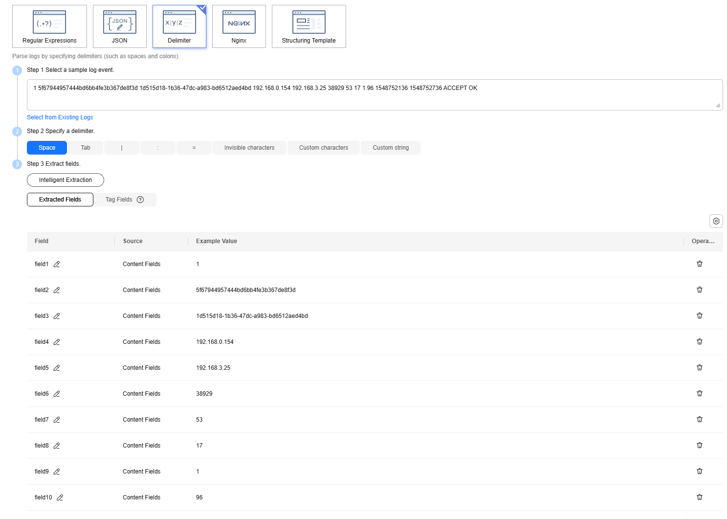

Delimiter
Logs can be parsed by delimiters, such as commas (,), spaces, or other special characters.
    There are three types of time range: relative time from now, relative time from last, and specified time. Select a time range as required.
    • From now: queries log data generated in a time range that ends with the current time, such as the previous 1, 5, or 15 minutes. For example, if the current time is 19:20:31 and 1 hour is selected as the relative time from now, the charts on the dashboard display the log data that is generated from 18:20:31 to 19:20:31.
    • From last: queries log data generated in a time range that ends with the current time, such as the previous 1 or 15 minutes. For example, if the current time is 19:20:31 and 1 hour is selected as the relative time from last, the charts on the dashboard display the log data that is generated from 18:00:00 to 19:00:00.
    • Specified: queries log data that is generated in a specified time range.
  2. Select or customize a delimiter.
    • For invisible characters, enter up to 4 hexadecimal characters starting with 0x for each delimiter, for example, 0x01. A maximum of 32 invisible characters can be entered.
    • For custom characters, enter 1 to 10 characters, each as an independent delimiter.
    • For a custom string, enter 1 to 30 characters as one whole delimiter.
    Enter the following sample raw log in the text box and click Intelligent Extraction. Figure 4 shows the automatically generated fields.
    1 5f67944957444bd6bb4fe3b367de8f3d 1d515d18-1b36-47dc-a983-bd6512aed4bd 192.168.0.154 192.168.3.25 38929 53 17 1 96 1548752136 1548752736 ACCEPT OK
    Figure 4 Field extraction result of the delimiter method
    The float data type has seven digit precision.
    If a value contains more than seven valid digits, the extracted content is incorrect, which affects quick analysis. In this case, you are advised to change the field type to string.

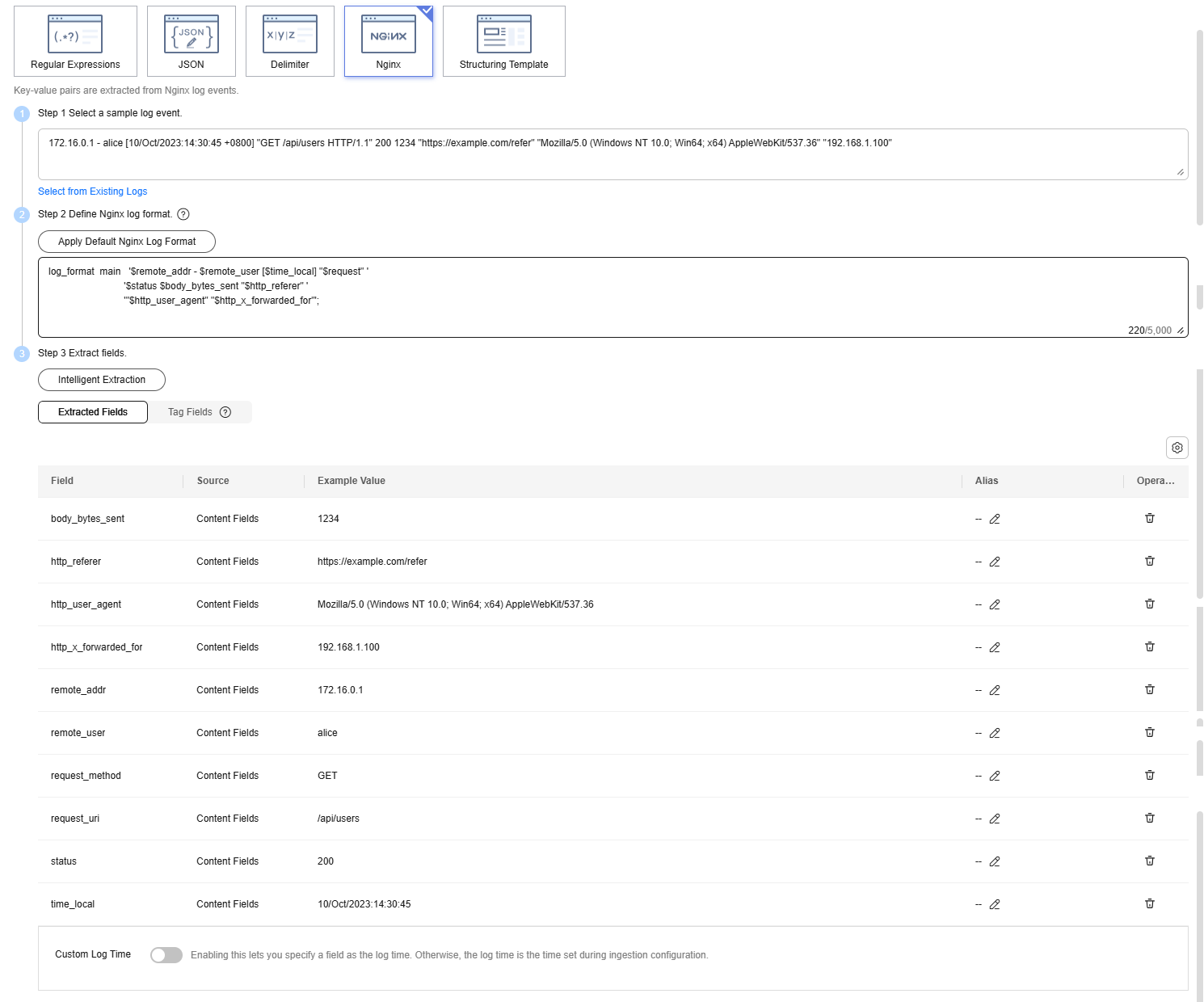

Nginx
You can customize the format of access logs by the log_format command.
  2. Define the Nginx log format. You can click Apply Default Nginx Log Format to apply the default format.
    In standard Nginx configuration files, the portion starting with log_format indicates the log configuration.
    • The default configuration is as follows. For details about the default fields, see Table 2. For details about the common extended fields, see Table 3.
      log_format  main   '$remote_addr - $remote_user [$time_local] "$request" '
                                  '$status $body_bytes_sent "$http_referer" '
                                  '"$http_user_agent" "$http_x_forwarded_for"';

    • You can also customize a format. The format must meet the following requirements:
      • Must be configured using Nginx and cannot be empty.
      • Must start with log_format and contain apostrophes (') and field names.
      • Can contain up to 5,000 characters.

    Enter the following sample raw log in the text box and click Intelligent Extraction. Figure 5 shows the automatically generated fields.
    172.16.0.1 - alice [10/Oct/2023:14:30:45 +0800] "GET /api/users HTTP/1.1" 200 1234 "https://example.com/refer" "Mozilla/5.0 (Windows NT 10.0; Win64; x64) AppleWebKit/537.36" "192.168.1.100"
    Configure the following Nginx log format in Step 2.
    Figure 5 Field extraction result of the Nginx method
