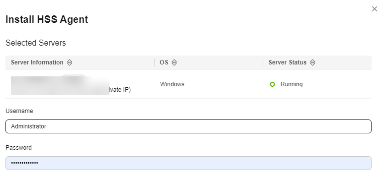

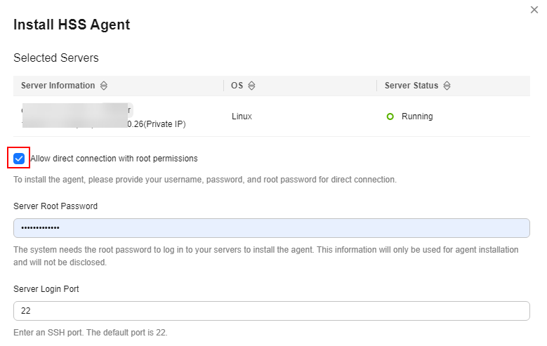

- Select a server and click Next.
- Enter a username and password as prompted.
- Confirm the information and click OK.

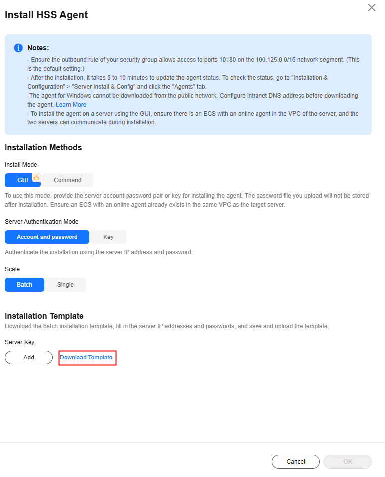

- Upload the installation template.
- Click Download Template to download the batch installation template to your local PC.
Figure 4 Downloading the batch installation template
- Open the downloaded file, fill in server information as required, and save the file.
- Click Select File and upload the file.
HSS will automatically match the servers based on IP addresses. If the matching fails, you can click View Failed Servers and check the failure cause.

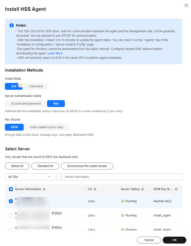

- Install Mode: Select GUI.
- Server Authentication Mode: Select Key.
- Key Source: Select DEW.
- Server Group (Optional): Select a server group for the server for easier management. You can select an existing server group from the drop-down list or click Create Server Group to create one. After the server group is created, click
to refresh the server group list. Then, you can select the new server group.
- Select servers and click OK.
In the server list, only the servers bound to DEW are displayed.
Figure 5 Selecting servers
- In the row of a server, check its agent installation progress in the Agent Status column.
If the Agent Status is Online, the agent has been installed.

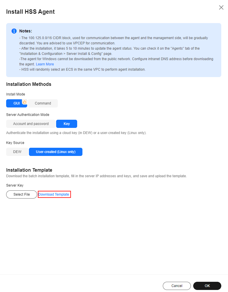

Figure 6 Downloading the batch installation template
HSS will automatically parse the file and identify the servers you specified. If the parsing fails, you can click View Failed Servers and check the failure cause.

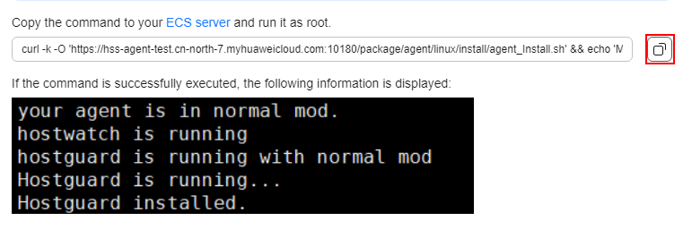

- On the console page, click
in the Install HSS Agent dialog box to copy the installation command.
Figure 7 Copying the installation command

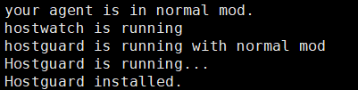

- Log in to the server as the root user and paste the installation command.
If the command output shown in Figure 8 is displayed, the agent has been installed.
Figure 8 Agent installed
- Wait for 5 to 10 minutes and return to the HSS console. On the Server Install & Config page, click the Agents tab, and click Servers with Agents. Check the agent status of the target server.

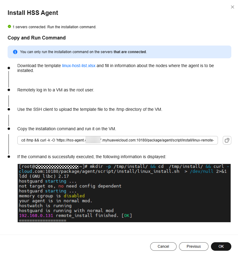

- Enter the server information based on the requirements in the linux-host-list.csv template and save the template.
Ensure that the entered server verification information is consistent with the verification mode selected in 7.

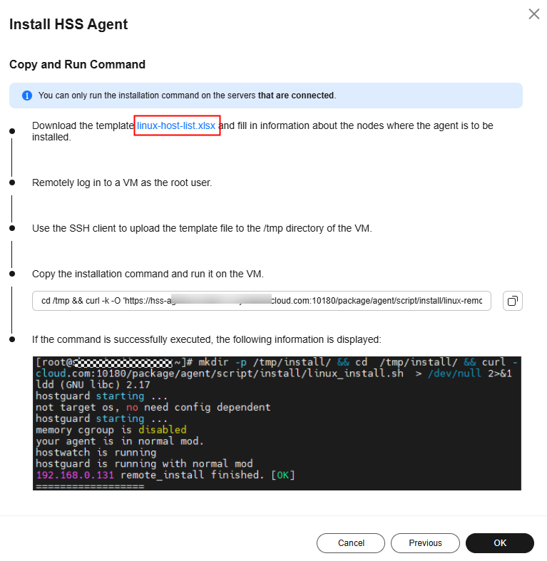

- Use the root account to remotely log in to any target server.
- Use the SSH client to upload the linux-host-list.csv file to the /tmp directory on the server.

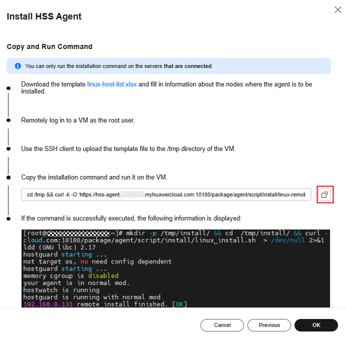

- Return to the HSS console. In the Install HSS Agent dialog box, click
Figure 10 Copying the installation command

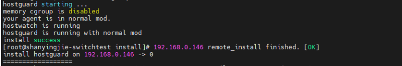

- Paste and run the installation command on the server to install the agent.
If the information shown in Figure 11 is displayed, the installation is complete.
Figure 11 Agent installed

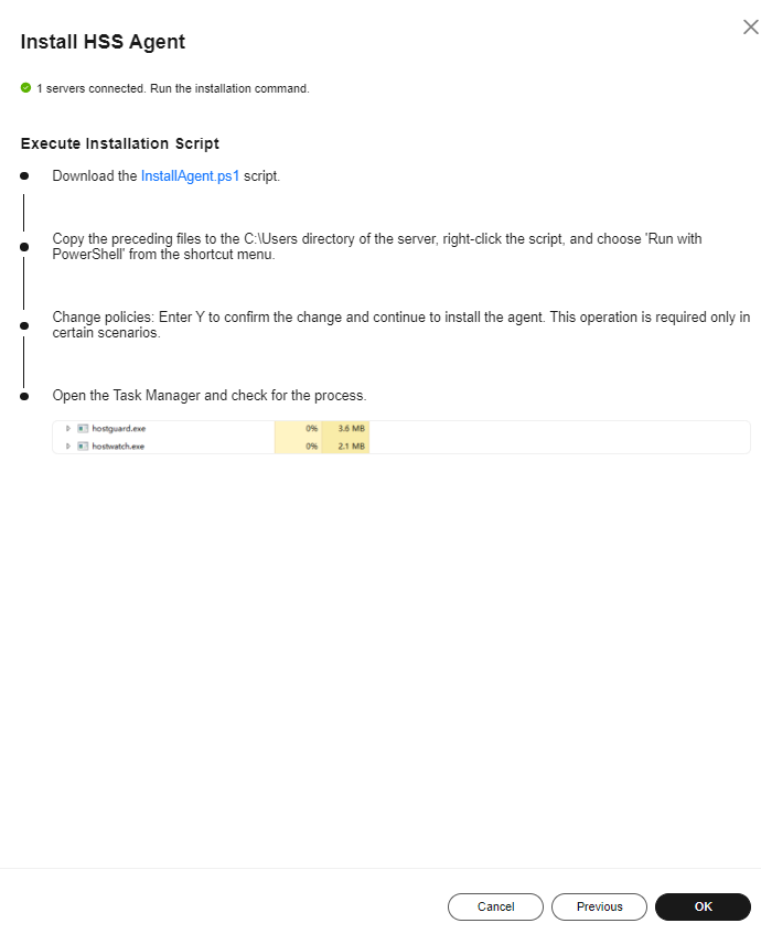

- On the console, click installAgent.ps1 in the Install HSS Agent dialog box to download the installation script.
Figure 12 Downloading installAgent.ps1

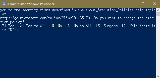

- (Optional) In the dialog box that is displayed, enter Y to run the script to install the agent.
If no dialog box is displayed, skip this step.
Figure 13 Changing the execution policy

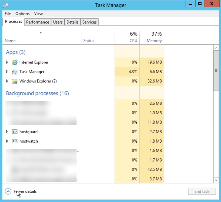

- After the execution, open the Task Manager and check whether hostguard.exe and hostwatch.exe exist. If they do, the agent has been installed.
Figure 14 Agent installed

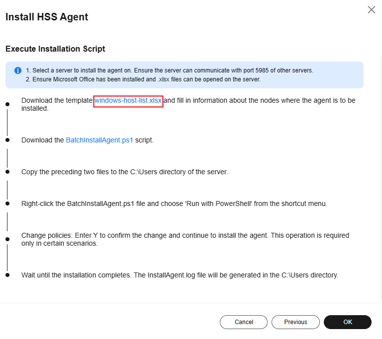

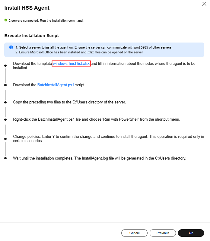

- On the console, click windows-host-list.xlsx in the Install HSS Agent dialog box to download the template to the local PC.
Figure 15 Downloading windows-host-list.xlsx
- Enter server information based on the requirements in the windows-host-list.xlsx template and save it.

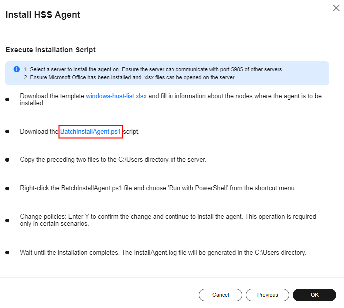

- Return to the HSS console and click BatchInstallAgent.ps1 to download the installation script.
Figure 16 Downloading BatchInstallAgent.ps1
- Log in as user Administrator to a server where the agent is to be installed.
- Copy the windows-host-list.xlsx and BatchInstallAgent.ps1 files to the C:\Users directory of the server where the agent is to be installed.
- Right-click BatchInstallAgent.ps1 and choose Run with PowerShell.
Figure 17 Changing the execution policy
- After the script is executed successfully, check whether the BatchInstallAgent.log file exists in C:\Users\Administrator.
If the BatchInstallAgent.log file exists, the agent has been installed.
Figure 18 Copying the installation command
- Use the root account to log in to the server under account B. Paste and run the installation command.
If the command output shown in Figure 19 is displayed, the agent has been installed.
Figure 19 Agent installed

- On the console, click linux-host-list.csv in the Install HSS Agent dialog box to download the template.
Figure 20 Downloading linux-host-list.csv
- In the linux-host-list.csv template, fill in the information about account B's servers that need to be managed, and save the information.
- Use the root account to remotely log in to any of account B's servers that need to be managed.
Figure 21 Copying the installation command
If the information shown in Figure 22 is displayed, the installation is complete.
Figure 22 Agent installed
- Wait for 5 to 10 minutes. Return to the HSS console, choose , and click the Servers tab. Check whether managed servers are online. If yes, the cross-account management is successful.
Figure 24 Changing the execution policy
Figure 26 Downloading windows-host-list.xlsx
- In the windows-host-list.xlsx template, fill in the information about account B's servers that need to be managed, and save the information.
Figure 27 Downloading BatchInstallAgent.ps1
- Log in as user Administrator to a server that is to be managed and belongs to account B.
- Copy and paste the windows-host-list.xlsx and BatchInstallAgent.ps1 files to the C:\Users directory on any of account B's servers to be managed.
Figure 28 Changing the execution policy
