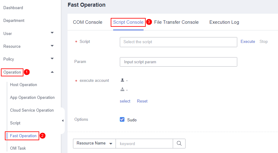

- Use the system administrator account to Log In to the CBH System.
- In the navigation tree on the left, choose . The Fast Operation page is displayed.
- Click the Script Console tab.
Figure 1 Accessing the Script Console

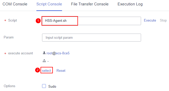

- Configure script O&M information. Script O&M parameters describes the parameters.
Figure 2 Configuring script O&M information
Table 1 Script O&M parameters Parameter
Description
Script
Select the HSS-Agent.sh script.
Param
Leave this parameter blank.
Execution account
Click select, and select the account or account group of the server where the agent is to be installed.
Options
This parameter is optional. By default, the script task is executed in the Sudoers file on the server. If the server account does not have the execute permission on the file, select Sudo.

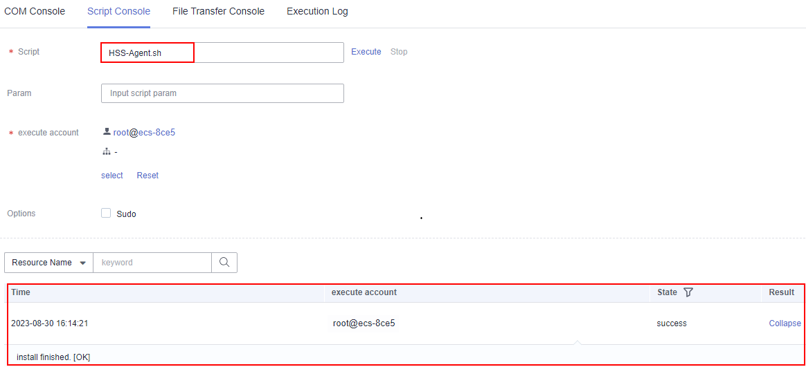

- Click Execute.
Figure 3 Executing a script task
- After the script task is successfully executed, click Collapse in the Result column to expand the execution result.
If install finished.[OK] is displayed, the agent is successfully installed.
Figure 4 Successfully executed a script task

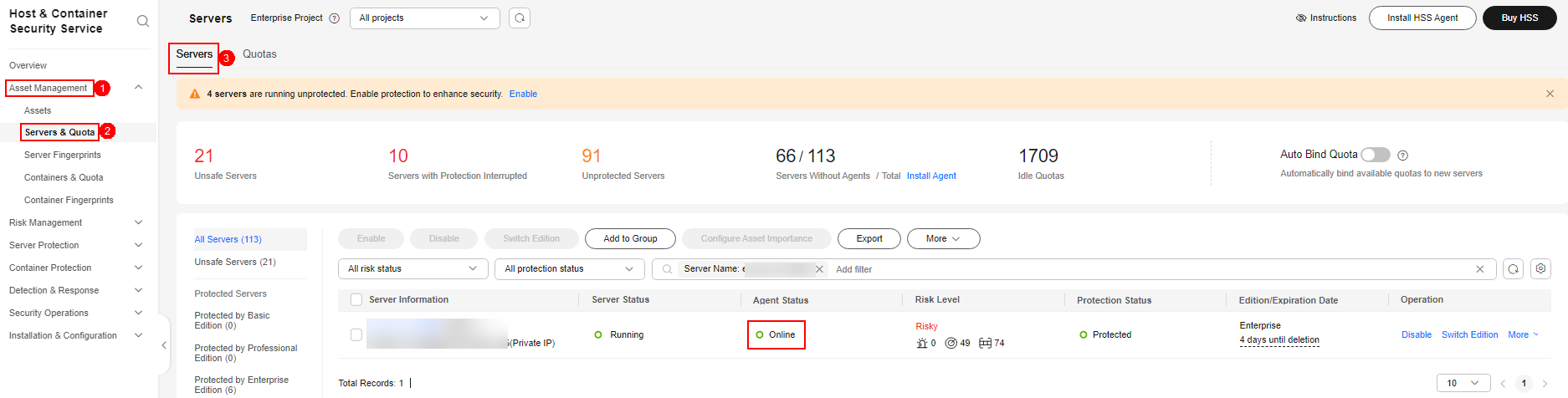

- On the HSS console, confirm the agent installation result.
- Log in to the HSS console.
- On the Servers tab page, check the agent status of the target server, as shown in Checking the agent status.
If the agent status is Online, the agent is successfully installed.
