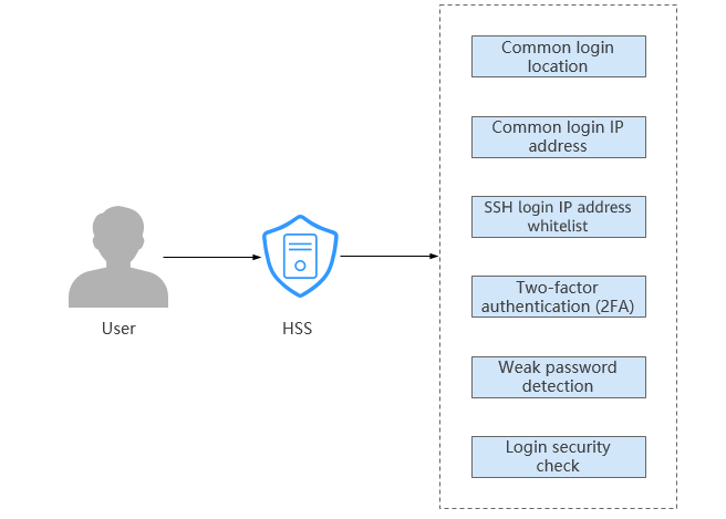

Solution Architecture and Advantages
You can configure common login locations, common login IP addresses, SSH login IP address whitelist, two-factor authentication, weak password check, and login security check to protect login security.
Figure 1 Security hardening for server logins
  • Common login location
    After you configure common login IP addresses, HSS will generate alarms on the logins from other login IP addresses.
  • Common login IP address
  • SSH login IP address whitelist
    The SSH login whitelist controls SSH access to servers, preventing account cracking.
  • Two-factor authentication (2FA)
    2FA requires users to provide verification codes before they log in. The codes will be sent to their mobile phones or email boxes.
  • Weak password detection
    Weak passwords are not attributed to a certain type of vulnerabilities, but they bring no fewer security risks than any type of vulnerabilities. Data and programs will become insecure if their passwords are cracked.
    HSS proactively detects the accounts using weak passwords and generates alarms for the accounts. You can also add a password that may have been leaked to the weak password list to prevent server accounts from using the password.
  • Login security check
    After login security detection policy is configured, you can enable login security check for the target server. HSS will effectively detect brute force attacks, automatically block brute force IP addresses, and trigger and report alarms.

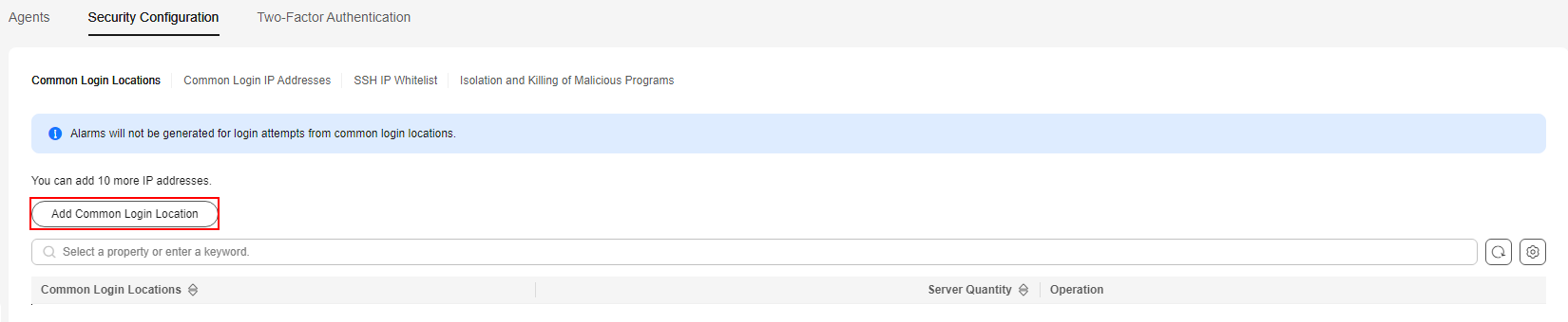

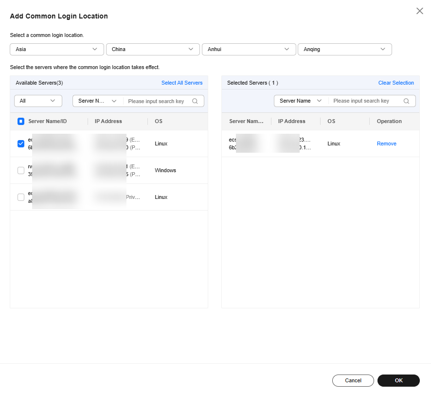

  3. Configure common login locations.
    An account can add up to 10 common login locations.
    1. In the navigation pane, choose Installation & Configuration > Server Install & Config.
    2. Click the Security Configuration tab page and click Common Login Locations.
    3. Click Add Common Login Location.
      Figure 2 Adding a common login location
    4. In the dialog box, select the common login location to be added and the server where the common login location takes effect. After confirming that the information is correct, click OK.
      You can select multiple servers where the common login location takes effect.
    5. Return to the Common Login Locations sub-tab and check the added common login locations.

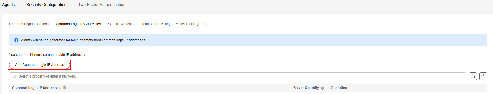

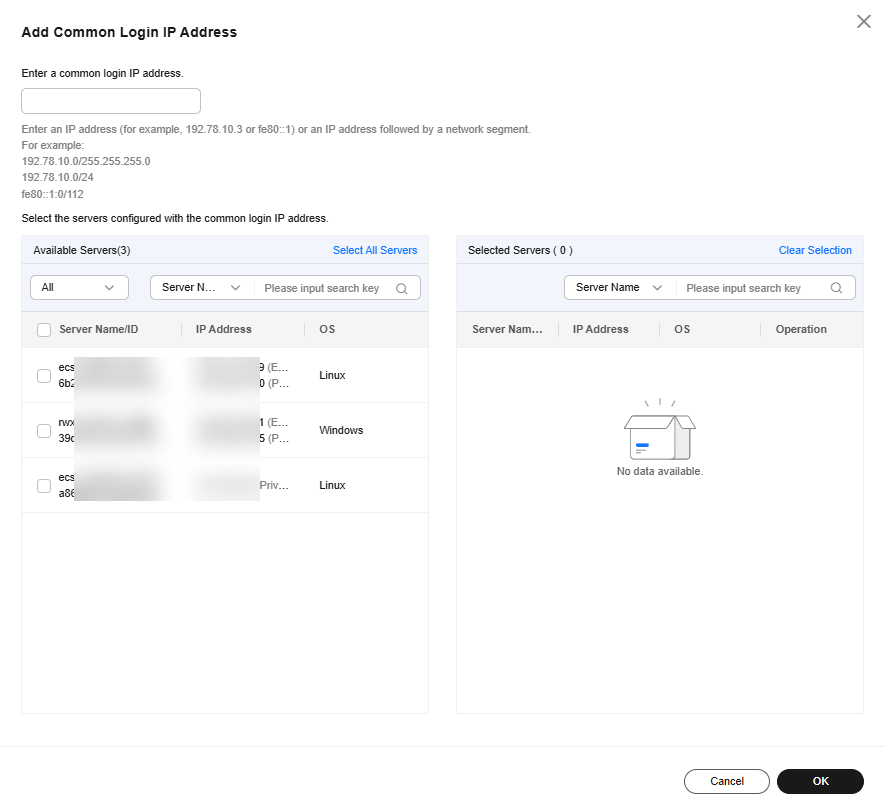

  4. Configure common login IP addresses.
    An account can add up to 20 common login IP addresses.
    1. Click the Security Configuration tab page and click Common Login IP Addresses.
    2. Click Add Common Login IP Addresses.
      Figure 3 Adding a common login IP address
    3. In the dialog box that is displayed, enter a common login IP address and select servers. Confirm the information and click OK.
      • Common login IP address: Enter one EIP or IP address segment at a time. To add multiple values, repeat this operation until all of them are added.
      • Servers: You can select multiple servers to apply the setting.
    1. Return to the Common Login IP Addresses sub-tab and check the added common login IP addresses.

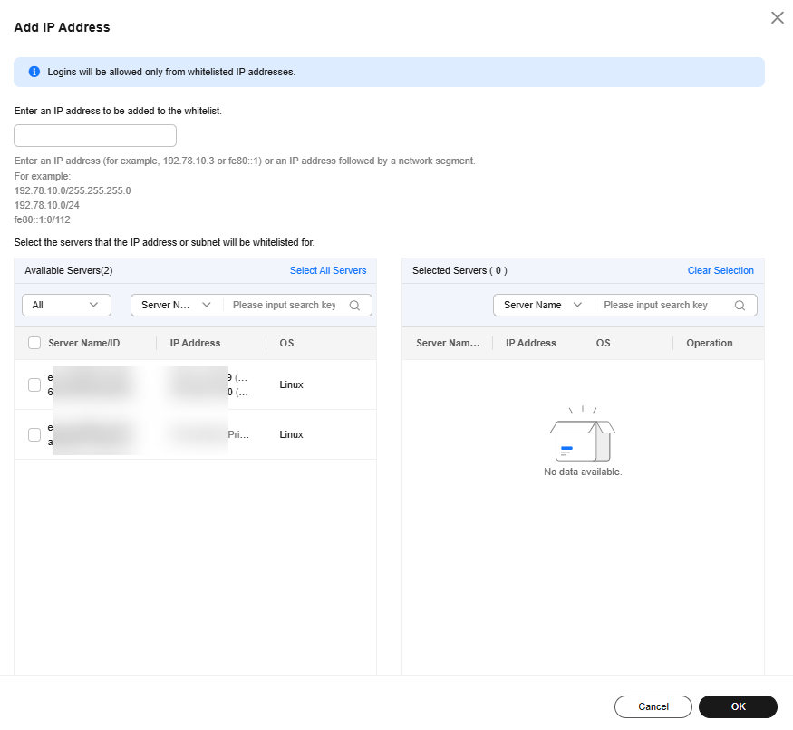

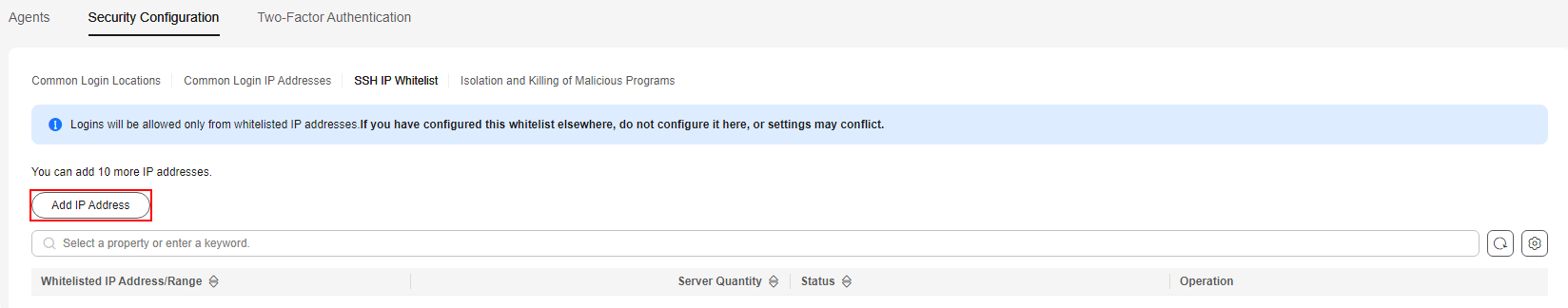

  5. Configure an SSH login IP address whitelist.
    1. Click the Security Configuration tab page and click SSH IP Whitelist.
    2. Click Add IP Address.
      Figure 4 Configuring an IP address whitelist
    3. In the dialog box that is displayed, enter an IP address to be added to the whitelist and select servers. Confirm the information and click OK.
      • Whitelist IP address: Enter one IP address or IP address segment at a time. To add multiple values, repeat this operation until all of them are added. Up to 10 IP addresses or IP address segments can be added.
    4. Return to the SSH IP Whitelist sub-tab and check the added IP whitelist.

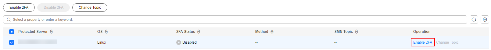

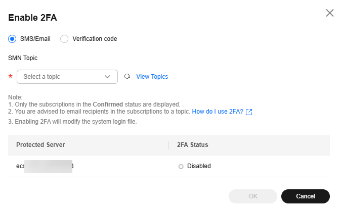

  6. Configure 2FA.
    1. Click the Two-Factor Authentication tab page.
    2. Click Enable 2FA in the Operation column of a server.
      Select servers and click Enable 2FA to enable 2FA for the servers at a time.

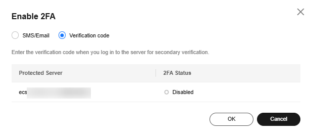

      Figure 5 Enabling 2FA
    3. In the dialog box, select the authentication mode.
      • SMS/Email
        You need to select an SMN topic for SMS and email verification.
        • The drop-down list displays only notification topics that have been confirmed.
        • If there is no topic, click View to create one. For details, see Creating a Topic.
        • If your topic contains multiple mobile numbers or email addresses, during two-factor authentication,
          • If you use a mobile phone number for verification, all the endpoints (mobile numbers and email addresses) in the topic will receive a verification code.
          • If you use an email address for verification, only this address will receive a verification code.
          You can delete the mobile numbers and email addresses that do not need to receive verification messages.
        Figure 6 SMS/Email verification
      • Verification code
        Use the verification code you receive in real time for verification.
        Figure 7 Setting Method to Verification code
    4. Click OK.
    5. Return to the Two-Factor Authentication tab. Check whether the 2FA Status of the target server changes to Enabled.
      It takes about 5 minutes for the 2FA settings to take effect.

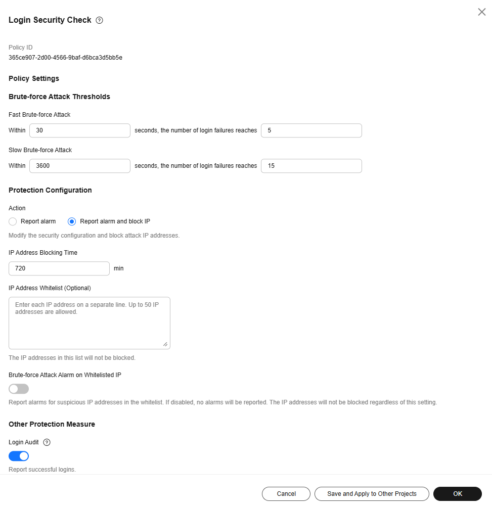

  2. Configure login security checks.
    1. Click Login Security Check. The Login Security Check dialog box is displayed.
    2. Modify the parameters in the Policy Settings based on the site requirements. For details about the parameters, see Table 2.
      Figure 8 Modifying the security check policy
      Table 2 Parameter description
      Parameter
      Description
      Fast Brute-force Attack
      Rule for determining a fast brute-force attack.
      • Consecutive Login interval: Enter an integer in the range 10 to 180, in the unit of seconds. The default value is 30.
      • Consecutive login failures: Enter an integer in the range 3 to 30. The default value is 5.
      Slow Brute-force Attack
      Rule for determining a slow brute-force attack.
      • Consecutive Login interval: Enter an integer in the range 1,800 to 7,200, in the unit of seconds. The default value is 3600.
      • Consecutive login failures: Enter an integer in the range 10 to 60. The default value is 15.
      Action
      • Report alarm: An alarm is generated for a brute-force attack, but the IP address of the brute-force attack is not blocked.
      • Report alarm and block IP: An alarm is generated for a brute-force attack, and the IP address of the brute-force attack is blocked. Note: If the software in a container is attacked, the IP address of the brute-force attack is not automatically blocked. Only an alarm is generated.
      IP Address Blocking Time
      IP address blocking duration, ranging from 1 to 525,600. A blocked IP address cannot be used for login within the duration. After the duration ends, the IP address is automatically unblocked. The default value is 720 minutes.
      IP Address Whitelist
      After an IP address is added to the whitelist, HSS does not block brute-force attacks from the IP address in the whitelist. A maximum of 50 IP addresses or network segments can be added to the whitelist. Both IPv4 and IPv6 addresses are supported.
      Brute-force Attack Alarm on Whitelisted IP
      If it is enabled, the system generates alarms for brute-force attacks from whitelisted IP addresses, but does not block the IP addresses.
      Login Audit
      After this function is enabled, the system reports successful SSH logins, detects remote logins, and generates alarms for remote logins.
    3. Confirm the information and click OK.
