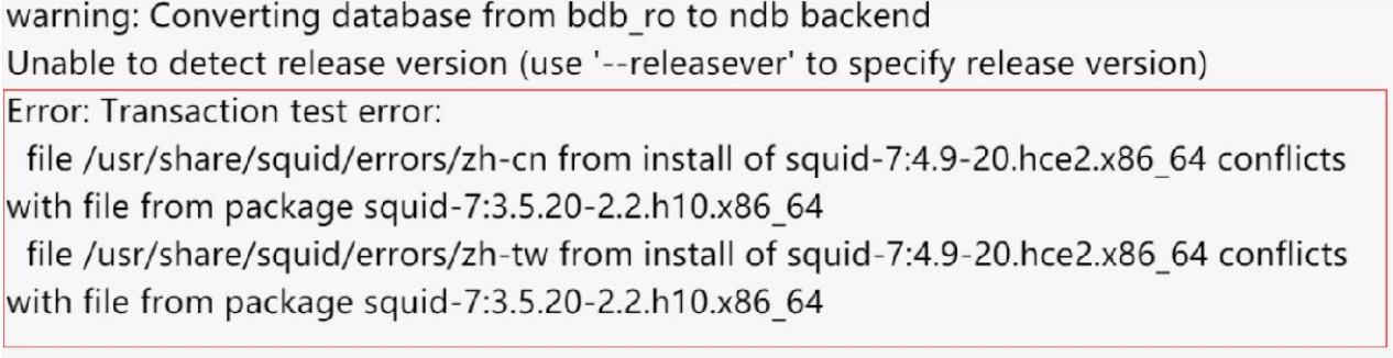

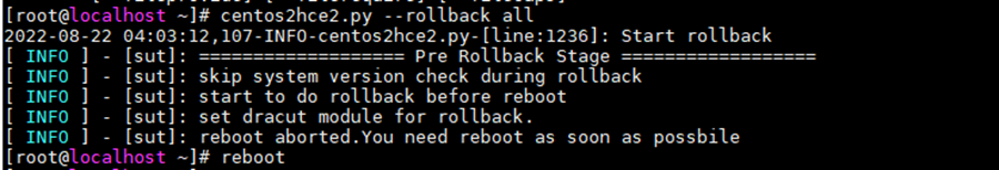

- If an upgrade failed due to network interruption or software package conflicts, run the migration command again.
- If the error message in Figure 3 is displayed during an upgrade, the upgrade is interrupted due to package conflicts. Handle the conflicts and try the upgrade again. For details about how to handle package conflicts, see Conflicting Packages.
- Reboot the server by running reboot. If the reboot command does not respond, run reboot -f instead.

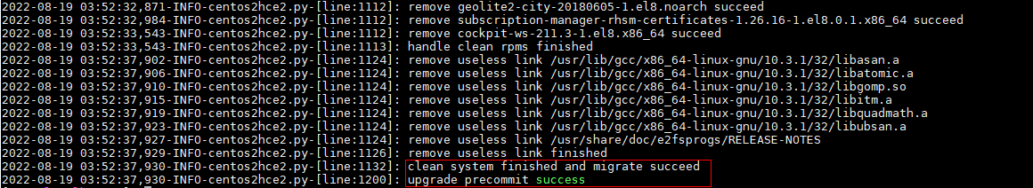

- Delete the files of the source OS's components.
After the OS migration, the components of the source OS will be replaced by those of HCE. However, the component files of the source OS are still stored in the system. You need to run centos2hce2.py --precommit upgrade to delete such files.
If the message "upgrade precommit success" is displayed, the files have been successfully deleted.
Figure 5 Deleting component files of the source OS
The deletion can be performed for multiple times.

- Run centos2hce2.py --rollback all to roll back the system. After the rollback, run reboot to restart the system.
Figure 7 System rollback and restart

Run centos2hce2.py --commit all to clear the data.
The system will automatically delete the system data of the source and target OSs, including the system data in the backup directory mentioned in step 3.
[root@localhost ~]# centos2hce2.py --commit all 2022-08-22 04:45:32,601-INFO-centos2hce2.py-[line:1242]: commit migration
