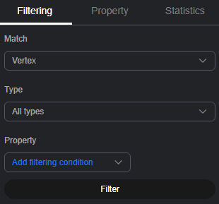

  2. Click on the right of the canvas, or select a vertex on the canvas, right-click it , and choose View Property, to display the Filtering and Property page.
  3. In the Filtering and Property area, set the filtering conditions and click Filter.
    • Match: Vertex is selected by default. Possible values are Vertex and Edge.
    • Type: All types is selected by default. You can select the vertex or edge type from the drop-down list. The type is defined by the metadata file you upload.
    • Add filtering condition: Click Add filtering condition to select a property and choose a condition (Less than, Greater than, Equal to, Not equal to, In range, Existent, Non-existent, Greater than or equal to, or Less than or equal to). Properties are defined by the metadata file you upload. You can add multiple filtering conditions or click Delete to delete set conditions.
      Figure 1 Setting filtering conditions
  4. After the execution is complete, the filtering result is displayed in the drawing area and result area.
