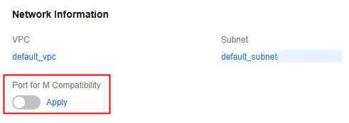

  5. In the Network Information area, click or Apply in the Port for M Compatibility field.
    Figure 1 Setting the M compatibility port

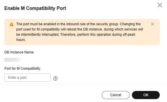

  6. In the displayed dialog box, set the M compatibility port, and click OK.
    • The port ranges from 1024 to 39989, but the following ports that are reserved for system use cannot be used: 2378 to 2380, 2400, 4999 to 5001, 5100, 5500, 5999 to 6001, 6009, 6010, 6500, 8015, 8097, 8098, 8181, 9090, 9100, 9180, 9187, 9200, 12016, 12017, 20049, 20050, 21731, 21732, 32122 to 32126, and 39001
    • The port cannot be a number in the range [Database port, Database port + 10].
    Figure 2 Enabling M compatibility port
