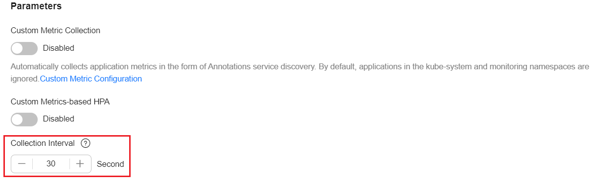

Adjusting the Collection Interval
For a cluster with at least 200 nodes or 10,000 pods, adjust the collection interval to 60 or 30 seconds to prevent system overload caused by frequent data collection.
- Log in to the CCE console and click the cluster name to access the cluster console.
- In the navigation pane, choose Add-ons. On the displayed page, locate the Cloud Native Cluster Monitoring add-on and click Edit. In Parameters, change the value of Collection Interval.
- Click OK and wait until the add-on update is complete.

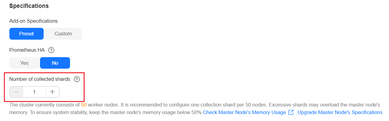

Adjusting the Number of Shards for Prometheus-based Data Collection
Adjusting the number of shards will increase the memory usages of the master nodes in the cluster, especially the memory usage of kube-apiserver. Do not adjust the number of shards in peak hours.
To meet the performance requirements of Prometheus in large-scale cluster monitoring, you can adjust the number of shards to allocate collection tasks to multiple Prometheus instances. This reduces the AOM load and improves the overall performance. You are advised to create one shard for every 75 nodes (or every 50 nodes if there is a large number of custom metrics or pods). A maximum of 32 shards can be created.
- In the navigation pane, choose Add-ons. On the displayed page, locate the Cloud Native Cluster Monitoring add-on and click Edit. In Specifications, change the number of shards.

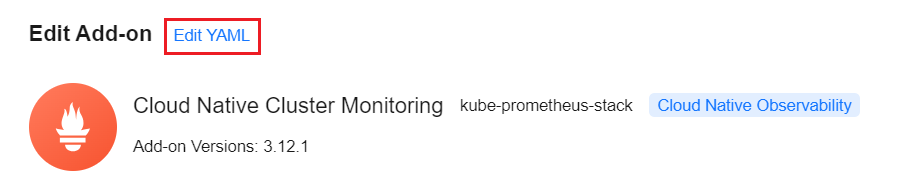

- In the navigation pane, choose Add-ons. On the displayed page, locate the Cloud Native Cluster Monitoring add-on and click Edit. Then, click Edit YAML above the add-on name.
- Set operator_manage_ksm to true and ksm_shards to the recommended value.
- Click OK and wait until the add-on update is complete. You can view the workload of each sharded kube-state-metrics on the Pods tab.
