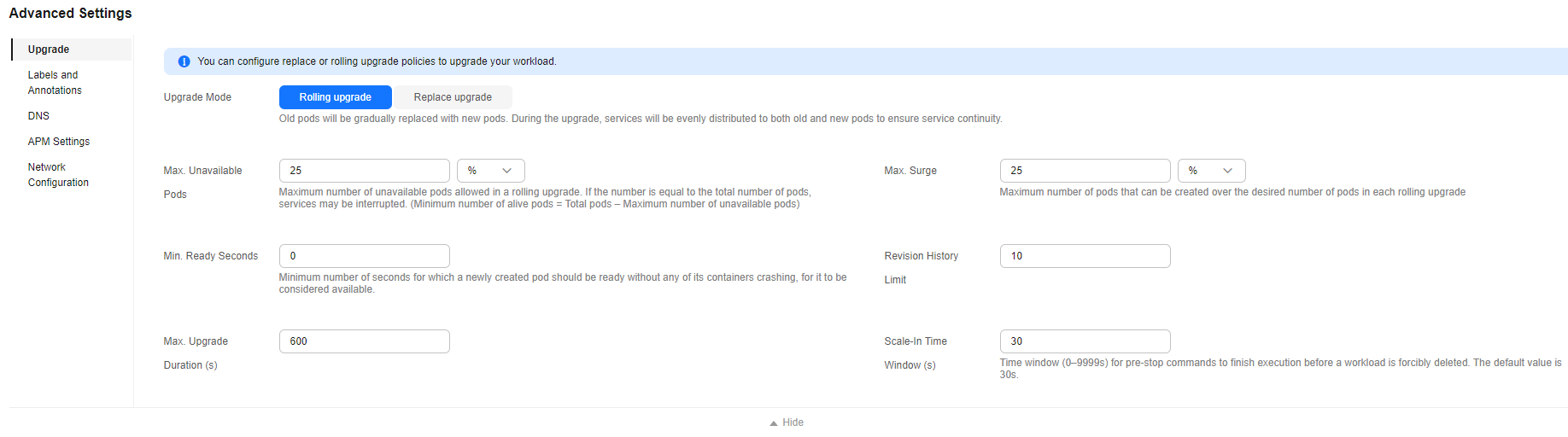

- In Advanced Settings, click Upgrade, and configure the parameters. The common parameters for rolling upgrades and replace upgrades serve similar purposes, though their implementations differ. Figure 1 Configuring a workload upgrade policy

Max. Unavailable Pods (maxUnavailable)
The maximum number or percentage of pods that can be unavailable during a rolling upgrade. This also sets the limit for how many running pods can be below the expected number. The default value is 25%. During an upgrade, the percentage is converted into an absolute number and rounded down.
For example, if spec.replicas is set to 2, no pods (2 × 0.25 = 0.5, rounded down to 0) can be unavailable. Therefore, during an upgrade, there will always be at least two pods running (2 desired – 0 unavailable). Each old pod is deleted only after a new one is created, ensuring that at least two pods are always running until all pods are updated.
This parameter is only available for Deployments.
Max. Surge (maxSurge)
The maximum number or percentage of pods that can exist above the desired number of pods during a rolling upgrade. This parameter determines the maximum number of new pods that can be created at a time to replace old pods. The default value is 25%. During an upgrade, the percentage is converted into an absolute number and rounded up.
For example, if spec.replicas is set to 2, a maximum of one pod (2 x 0.25 = 0.5, rounded up to 1) can be created at a time by default. Therefore, during an upgrade, up to 3 pods can exist (2 desired + 1 surge).
Min. Ready Seconds (minReadySeconds)
The minimum duration a new pod must remain in the ready state before it is marked as available.
This ensures a stable observation period, preventing unstable pods from joining the service too early and thereby improving the stability and reliability of the deployment.
Revision History Limit (revisionHistoryLimit)
The maximum number of old ReplicaSets retained for rollback. These consume etcd resources and appear in kubectl get rs output.
Each Deployment's historical configurations are stored in its corresponding ReplicaSet. Deleting an old ReplicaSet makes it impossible to roll back the Deployment to that version. By default, CCE retains the latest 10 old ReplicaSets.
Max. Upgrade Duration (progressDeadlineSeconds)
The maximum time, in seconds, that a Deployment can take to make progress before it is considered to be failing. If specifying this parameter, ensure its value is greater than minReadySeconds.
During a rolling upgrade, if a Deployment does not make progress within the time specified by progressDeadlineSeconds, it is marked with the following conditions: Type=Progressing, Status=False, and Reason=ProgressDeadlineExceeded. The above information indicates that the Deployment upgrade has failed. CCE records the failure event but does not automatically roll back the Deployment to a previous version. The rollback must be manually performed or triggered through an external mechanism.
Scale-In Time Window (terminationGracePeriodSeconds)
The maximum time kubelet waits for containers in a pod to exit gracefully when the pod is deleted. The default is 30 seconds. Containers should exit within this period. Otherwise, they will be forcibly terminated with SIGKILL.
