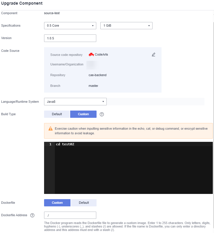

  3. Select the target component and click Upgrade in the Operation column.
  4. Configure the component again by referring to the following table.

    Figure 1 Upgrading a component
  5. Click Upgrade Now.
