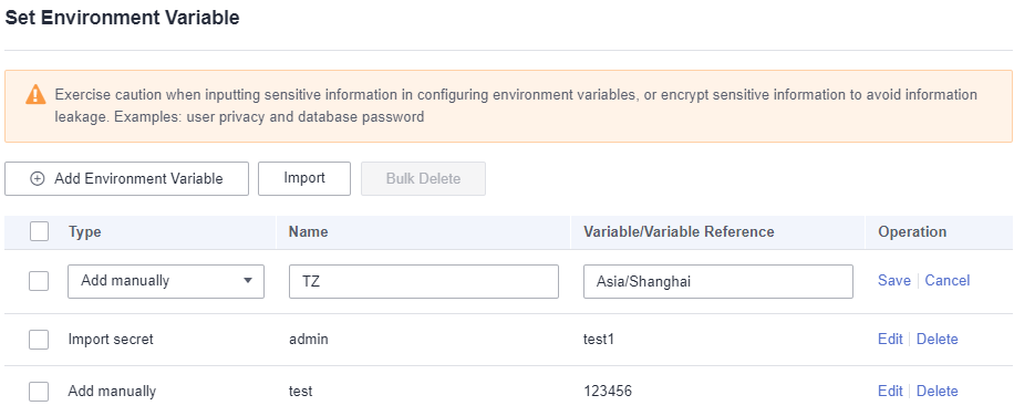

  5. Set the parameters by referring to Table 1.
    Table 1 Configuring an environment variable
    Parameter
    Description
    Type
    Select Add manually or Import secret.
    Name
    Name of an environment variable, which must be unique.
    Variable/Variable Reference
    Value of a variable.
    If Type is set to Import secret, select a created credential configuration from the drop-down list. For details, see Adding a Secret.
    For example, if you set Name to TZ and Variable/Variable reference to Asia/Shanghai, when the program code reads the TZ environment variable, Asia/Shanghai is obtained. You can view the time zone of Shanghai and the time difference between local and Shanghai time. The actual execution effect depends on the code.
    Figure 2 Configuring an environment variable

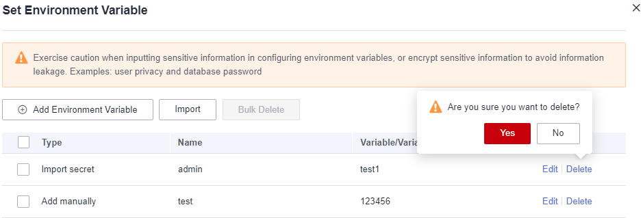

Deleting an Environment Variable
  1. Log in to CAE.
  2. Choose Component Configurations.
  3. Select the target component from the drop-down list in the upper part of the page.
    Figure 4 Selecting a component
  4. Click Edit in the Environment Variables module.
  5. Select the target configuration and click Delete in the Operation column. In the displayed dialog box, click Yes.
    Figure 5 Deleting an environment variable
  6. On the Set Environment Variable page, click OK.
