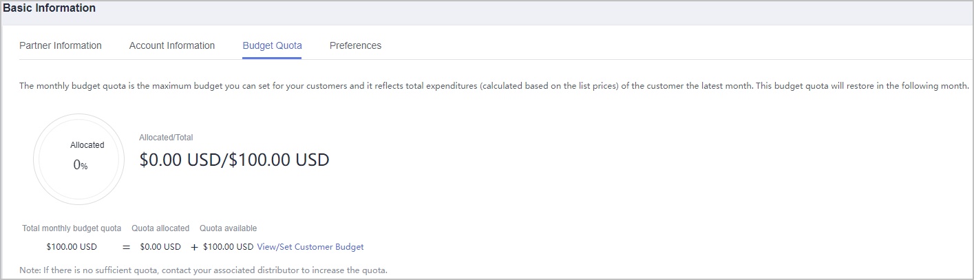

  • The budget set by you for your customers cannot exceed the budget quota configured by your distributor. You can view the monthly budget granted by your distributor in Partner Center > Partner Information > Basic Information > Budget Quota.

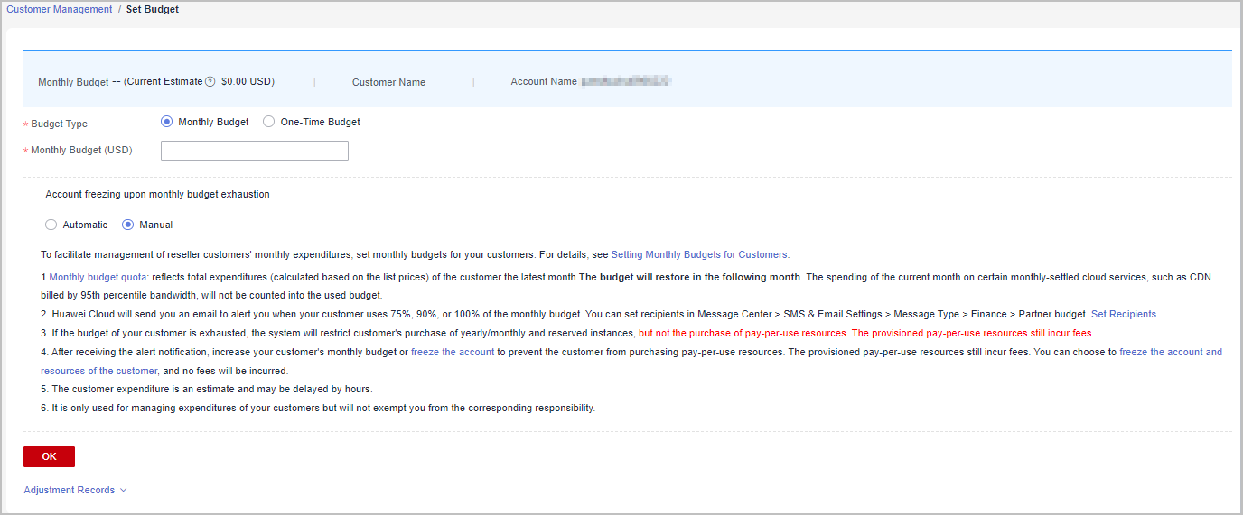

  2. On the customer list, select the target customer, and click Set Budget in the Operation column.
    You can select multiple customers and click Set Budget above the customer list to achieve batch budget setting. This method will overwrite the original budget of the customer.

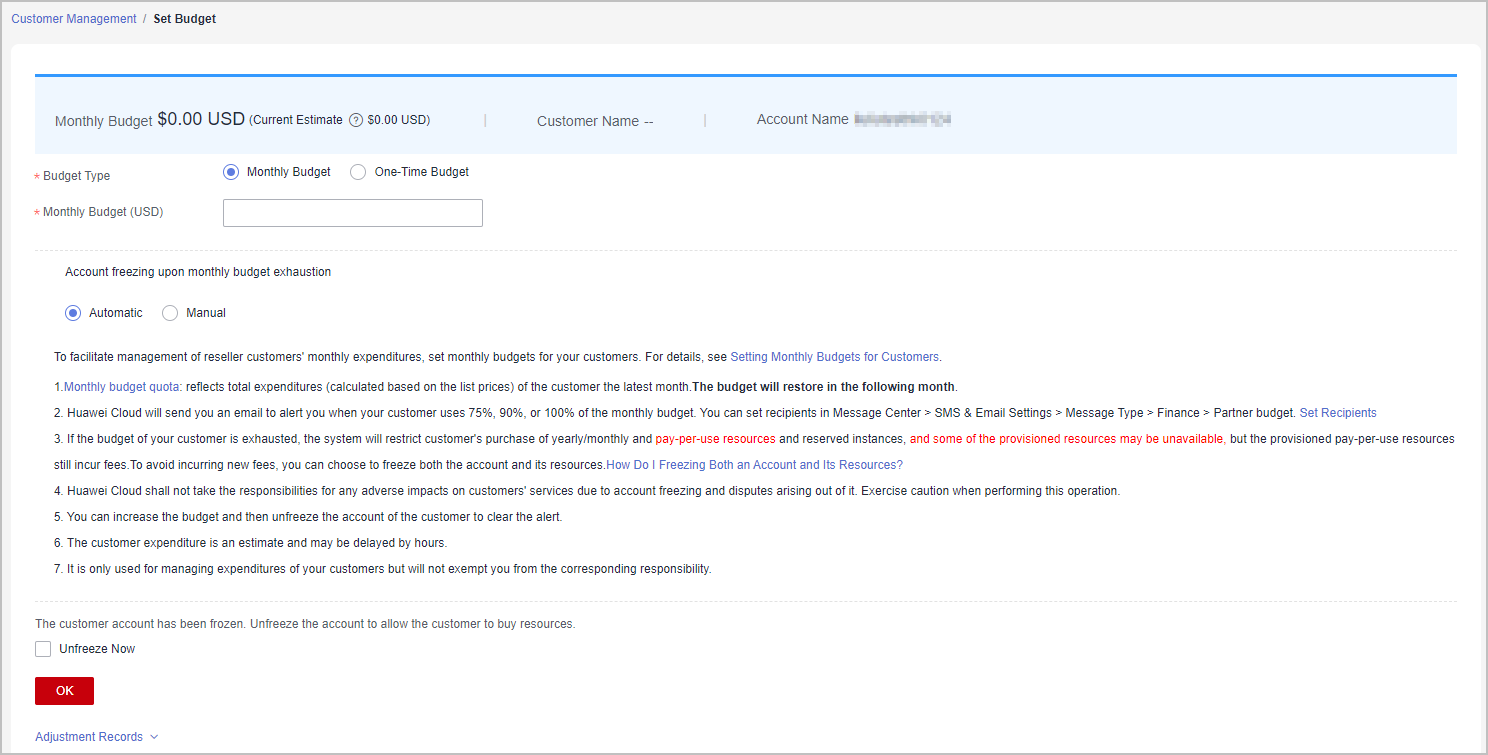

  3. Set Budget Type to Monthly Budget, enter a monthly budget value (which cannot be greater than the current available monthly quota), and select whether to automatically freeze the account upon budget exhaustion.
    • If a customer account is frozen, the customer cannot purchase resources. If you want to unfreeze the account, select Unfreeze Now and click OK.
    • After a customer is associated with a partner in the resale model, the customer account is frozen by default. When the account is frozen, the customer cannot buy, renew, or change resources. Some of the provisioned resources may be unavailable, but they still incur fees. The partner can select Unfreeze Now when setting a monthly budget for this customer.

    • Setting a budget is a sensitive operation. You are advised to enable the verification code function to enhance account security. For details about how to enable verification code function, see Managing Basic Information.
    • Automatic account freezing is a high-risk operation. If you select the automatic account freezing policy after the budget is exhausted, you must enter the verification code even if the verification code function is disabled.
