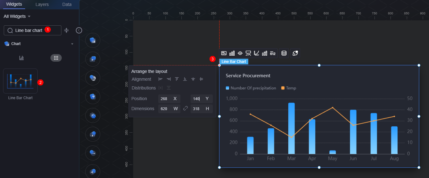

On the large screen design page, drag the line bar chart widget from All > Chart to the blank area of the canvas, as shown in Figure 1.
Figure 1 Line Bar Chart

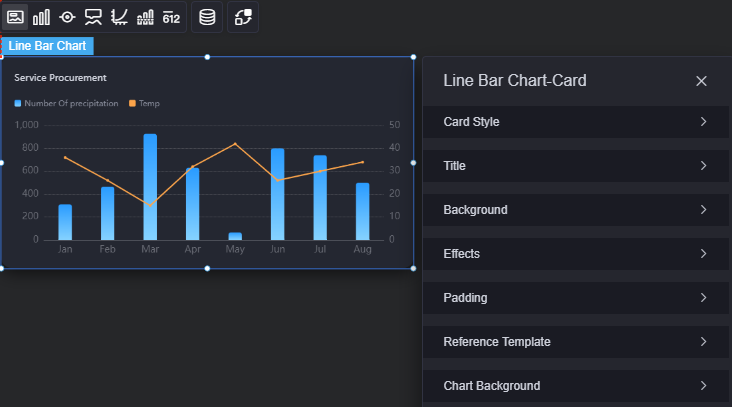

Card
A card wraps a chart widget. A widget consists of card elements (card title, chart, card background, and card border) and chart elements.
Figure 3 Line bar chart card
  • Card style: You can select a card style based on your service requirements. You can click the clear style button to clear the configured style.
  • Title
    • Title: Whether to display the widget title.
    • Content: Widget title.
    • Font: Font, size, and color of the title.
    • Align: Alignment mode of the title relative to the widget.
    • Background color: Background color of the title.
    • Padding: Distance between the title and the four sides of the widget box, in pixels by default.
      Figure 4 Padding
    • Title offset: Distance between the widget title and the line bar chart.
      Figure 5 Title offset
  • Background
    • Background color: Background color of the line bar chart.
    • Border: Border of the widget card. Options: no border, full border, and corner border. For full border and corner border, you can set the line type and rounded corners of the outer border of the widget.
    • Style: Image display style. The options are normal, center, stretch, and tiled.
    • Choose image: Use a local image as the widget background. Directories and subdirectories can be added to facilitate image management by category. JPG, JPEG, PNG, and GIF images are recommended. Each image cannot exceed 50 MB.
  • Special effect: Widget highlighted status. Displayed by default or on page load.

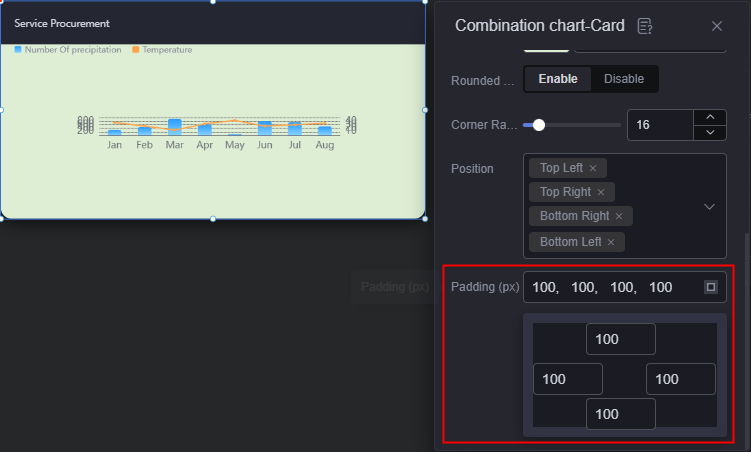

  • Padding: Distance between the chart in the widget and the four sides (top, bottom, left, and right) of the widget (see Figure 2). The default value is 0, indicating that the chart is stretched across the widget.
  • Reference template: Preset widget templates.

    • Border radius: Whether the chart background has round corners.
    • Border radius: Radius of the four corners. "0" indicates right angle, and "100" indicates round corner.
    • Positions: Positions to apply round corners.
    • Grid: Distance between the chart and the chart background on four sides.

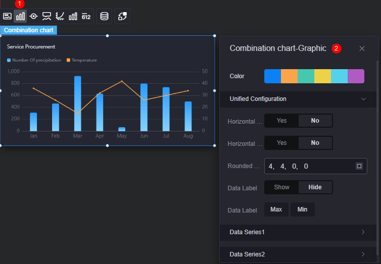

Graphic
A graphic is a specific graphical expression element that visualizes data in a widget. For example, a graphic can be a slice in a pie chart, a bar in a bar chart, or a line or an inflection point in a line chart.
Figure 7 Line bar chart graphic
  • Color: Color of the graphic.
  • Unified configuration
    • Horizontal stacking: Whether to display data in stacking mode (for multi-data series).
    • Horizontal bar: Whether to use horizontal bars.
    • Pillar fillet: Round corners of the bar border. "0" indicates right angle, and "100" indicates round corner.
    • Bar width: Width of the bar relative to the unit interval on the X axis.
    • Data label: Whether to display data labels (i.e. values) next to the bars. If it is enabled, the value position and color can be set.
    • Data label (max. and min.): Whether to display the maximum and minimum values.
  • Data Series
    • Series name: Default series name in the raw data. You can change the series name by configuring the display name.
    • Display name: Display name of the series in the chart.
    • Bar color: Color of the bars, which can be pure or gradient.
    • Customize the maximum bar: Customize the maximum value bar, including the color.
    • Data label: Whether to display data labels (i.e. values) next to the bars. If it is enabled, the value position, color, prefix, and suffix can be set.
    • Type of data series: Column or line.
    • Select the y-axis of which side to control: Left y-axis or right y-axis.

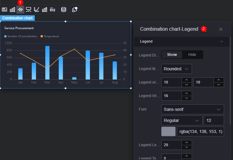

Legend
A legend shows the dimensions in a multi-dimensional visualized graphic expression.
Figure 8 Line bar chart legend
  • Legend display: Whether to display the legend. The legend text content comes from the value of s in the data model.
  • Legend mark: Set the shape of the icon and layout of legends.
  • Legend width and height: Width and height of legends.
  • Legend interval: Space between legends.
  • Font: Font, color, and size of legends. The legend text content comes from the value of s in the data model.
  • Legend left margin: Distance from the legend to the left of the bar widget.
  • Legend top margin: Distance from the legend to the top of the bar widget.
  • Page up button: Color of the page up button.
  • The page turning button is not activated: Color of the page up button in unavailable state.
  • Custom legend setting: After this function is enabled, you can adjust the display length of the legend name. By default, "Off" is selected, indicating that the entire legend name is displayed.

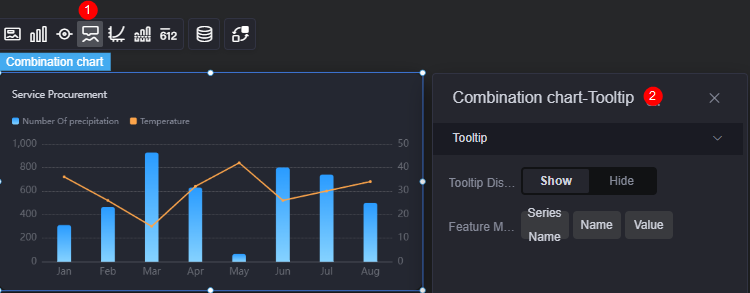

Tooltip
Tooltip (floating prompt) displays metrics of specific dimension nodes in a visualized chart widget.
Figure 9 Line bar chart tooltip
  • Tooltip display: After this function is enabled, the information is displayed when you place the cursor on a specific series during chart preview.
  • Feature marker: Content format of the tooltip box, such as series name, data name, and data value.

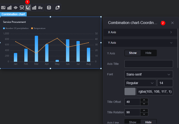

Coordinate
You can set the style, color, position, and behavior of the coordinate system for a chart widget.
Figure 10 Line bar chart coordinate
  • X axis
    • X axis: Whether to display the X axis.
    • Axis title: Title of the X axis.
    • Font: Font, color, and size of the axis.
    • Title offset: Offset of the title relative to the axis.
    • Title rotate: Rotation angle of the title.
    • Axis line: Whether to display the axis line. If the axis line is displayed, you can set its color.
    • Axis tick: Whether to display the scale.
    • Scale label: Scale label style, which can be automatic adjust label and all tags.
    • Scale label font: Font, font color, and font size of the scale label.
    • Label behavior: How to process a label that contains too many characters. The options include wrap up, omit, and ignore.
    • Number of words in a single line: Number of characters displayed in a single line. This parameter is required only when the label behavior is set to "Too Many Characters" or "Too Many Characters".
    • Label rotate: Rotation angle of labels.
    • Grid line: Whether to display grid lines.
    • Reverse: Whether to invert the axis data.
  • Y axis
    • Y axis: Whether to display the Y axis.
    • Axis title: Title of the Y axis.
    • Border: Whether to customize borders. If the maximum data is input as the minimum value, the initial y axis value is half of the maximum value.
    • Left Y Axis: Border range of the left Y axis. This parameter can be set when the border is custom.
    • Right Y Axis: Border range of the right Y axis. This parameter can be set when the border is custom.
    • Minimum interval: Minimum interval between coordinates. This parameter can be set when the border is custom.
    • Left Y axis unit: Unit of the left Y axis.
    • Right Y axis unit: Unit of the right Y axis.
    • Label show: Display style of labels, which can be "Default" or "Count Units".

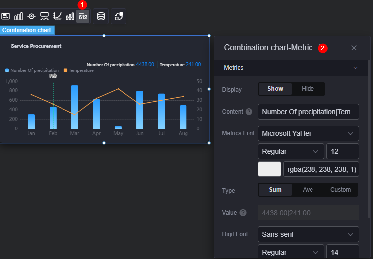

Metrics
Metrics provide supplementary text and number information to a graphic in a widget.
Figure 12 Line bar chart metrics
  • Metrics display: Whether to display metrics.
  • Metric content: metric content. An example of multi-data dimension configuration is data series 1 metric content|Data series 2 metric content.
  • Metrics font: Font, size, and color of the metric content.
  • Metrics value type: Metric type, which can be sum, average, or custom.
  • Metrics value: Set the value if the metrics value type is custom.
  • Number font: Font, size, and color of the data.
  • Metrics digit places: Number of digits after the decimal point.
