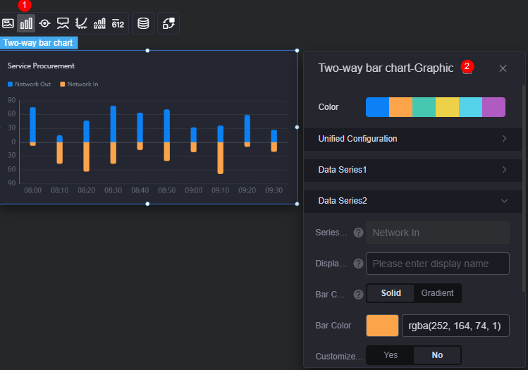

On the large screen design page, drag the two way bar chart widget from All > Chart to the blank area of the canvas, as shown in Figure 1.
Figure 1 Two-Way Bar Chart

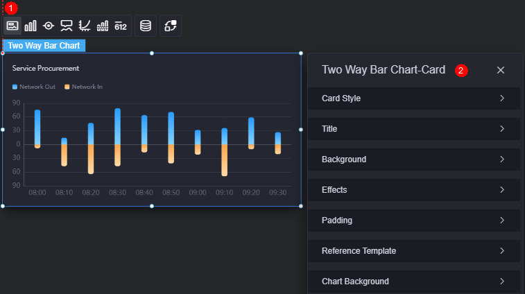

Card
A card wraps a chart widget. A widget consists of card elements (card title, chart, card background, and card border) and chart elements.
Figure 3 Two-way bar chart card
  • Card style: You can select a card style based on your service requirements. You can click the clear style button to clear the configured style.
  • Title
    • Title: Whether to display the widget title.
    • Content: Widget title.
    • Font: Font, size, and color of the text.
    • Align: Alignment mode of the title relative to the widget.
    • Background color: Background color of the title.
    • Padding: Distance between the title and the four sides of the widget box, in pixels by default.
      Figure 4 Padding
    • Title margin bottom: Distance between the widget title and the two-way bar chart.
      Figure 5 Title offset
  • Background
    • Background color: Background color of the widget card.
    • Border: Border of the widget card. Options: no border, full border, and corner border. For full border and corner border, you can set the line type and rounded corners of the outer border of the widget.
    • Style: Image display style. The options are normal, center, stretch, and tiled.
    • Choose image: Use a local image as the widget background. Directories and subdirectories can be added to facilitate image management by category. JPG, JPEG, PNG, and GIF images are recommended. Each image cannot exceed 50 MB.
  • Special effect: Widget highlighted status. Displayed by default or on page load.
  • Padding: Distance between the chart in the widget and the four sides (top, bottom, left, and right) of the widget (see Figure 2). The default value is 0, indicating that the chart is stretched across the widget.
  • Reference template: Preset widget templates.
  • Chart background: Background color of the chart.
    • Color setting: Background color of the chart.
    • Border radius: Whether the chart background has round corners.
    • Border radius: Radius of the four corners. "0" indicates right angle, and "100" indicates round corner.
    • Positions: Positions to apply round corners.
    • Grid: Distance between the chart and the chart background on four sides.
Graphic
A graphic is a specific graphical expression element that visualizes data in a widget, for example, a slice in a pie chart, a bar in a bar chart, a line or a kink point in a line chart.
Figure 6 Two-way bar chart graphic
  • Color: Color of the graphic.
  • Unified configuration
    • Horizontal stacking: Whether to display data in stacking mode (for multi-data series).
    • Horizontal bar: Whether to use horizontal bars.
    • Pillar fillet: Round corners of bars.
    • Bar width: Width of the bar relative to the unit interval on the X axis. The value range is from 1 to 100.
    • Data label: Whether to display data labels (i.e. values) next to the bars. After this function is enabled, you can set the value position and color.
    • Data label (max. and min.): Whether to display the maximum and minimum values.
  • Data Series
    • Series name: Default series name in the raw data. You can change the series name by configuring the display name.
    • Display name: The actual series name displayed in the chart.
    • Bar color: Color of the bars, which can be pure or gradient.
    • Customize the maximum bar: Customize the maximum value bar, including the color.
    • Pillar fillet: Round corners of the bar border. "0" indicates right angle, and "100" indicates round corner.
    • Data label: Whether to display data labels (i.e. values) next to the bars. After this function is enabled, you can set the value position, color, prefix, and suffix.

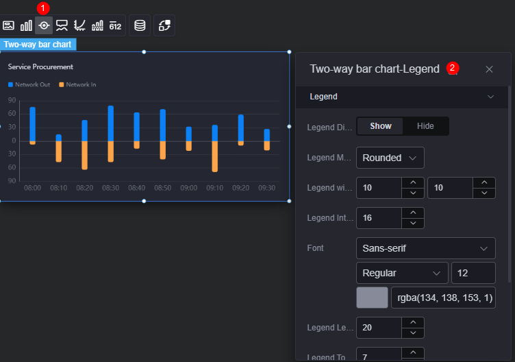

Legend
A legend shows the dimensions in a multi-dimensional visualized graphic expression.
Figure 7 Two-way bar chart legend
  • Legend display: Whether to display the legend. The legend text content comes from the value of s in the data model.
  • Legend marker: Shape of legend icons.
  • Legend width and height: Width and height of legends.
  • Legend interval: Space between legends.
  • Font: Font, color, and size of legends.
  • Legend left margin: Distance from the legend to the left of the bar widget.
  • Legend top margin: Distance from the legend to the top of the bar widget.
  • Page up button: Color of the page up button.
  • The page turning button is not activated: Color of the page up button in unavailable state.
  • Custom legend setting: After this function is enabled, you can adjust the display length of the legend name. By default, "Off" is selected, indicating that the entire legend name is displayed.

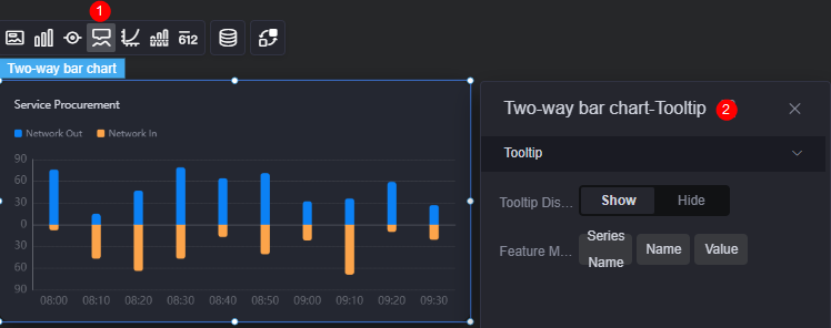

Figure 8 Two-way bar chart tooltip
  • Tooltip display: After this function is enabled, the information is displayed when you place the cursor on a specific series during chart preview.
  • Feature marker: Content format of the tooltip box, such as series name, data name, and data value.

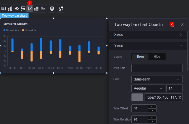

Coordinate
In the coordinate settings, you can set the X axis and Y axis of a chart, for example, whether to display the two axises and scale, and the font and font color.
Figure 9 Two-way bar chart coordinate
  • X axis
    • X axis: Whether to display the X axis.
    • Axis title: Title of the X axis.
    • Font: Font, color, and size of the axis.
    • Title offset: Offset of the title relative to the axis.
    • Title rotate: Rotation angle of the title.
    • Axis line: Whether to display the axis line. If the axis line is displayed, you can set its color.
    • Axis tick: Whether to display the scale.
    • Scale label: Scale label style, which can be automatic adjust label and all tags.
    • Scale label font: Font, font color, and font size of the scale label.
    • Label behavior: How to process a label that contains too many characters. The options include wrap up, omit, and ignore.
    • Number of words in a single line: Number of characters displayed in a single line. This parameter is required only when the label behavior is set to "Too Many Characters" or "Too Many Characters".
    • Label rotate: Rotation angle of labels.
    • Grid line: Whether to display grid lines.
    • Reverse: Whether to invert the axis data.
  • Y axis
    • Y axis: Whether to display the Y axis.
    • Axis title: Title of the Y axis.
    • Minimum interval: Minimum interval between coordinates.
    • Axis start value: Start value of the Y axis. To facilitate data display, when the input value is the maximum value of the ingested data, the start value of the Y axis in the chart is half of the maximum value.
    • Left Y axis unit: Unit of the left Y axis.
    • Axis max set: Whether to set the maximum value of the axis. You can enter a threshold.
    • Label show: Display style of Y axis labels, for example, "Default" or "Count Units".

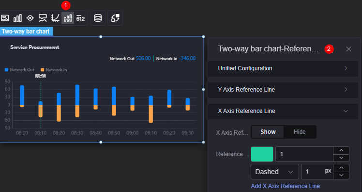

Reference Line
Reference lines are a visualized standard added to a chart widget to provide data reference.
Figure 10 Two-way bar chart reference line
  • Unified configuration: Style of the two ends of the reference line, such as circle, rectangle, and triangle.
  • Y axis reference line
    • Y axis reference line: Whether to display the Y axis reference line.
    • Reference line: Color and type of an existing reference line. To add a reference line, click Add Y Axis Reference Line. To delete a reference line, click x next to it.
  • X axis reference line
    • X axis reference line: Whether to display the X axis reference line.
    • Reference line: Color and type of an existing reference line. To add a reference line, click Add X Axis Reference Line. To delete a reference line, click x next to it.

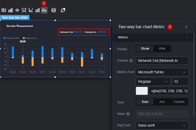

Metrics
Metrics supplement to all aspects except the visualized chart in a widget by using text and numbers, providing value reference for the widget.
Figure 11 Two-way bar chart metrics
  • Metrics display: Whether to display metrics.
  • Metric content: metric content. An example of multi-data dimension configuration is data series 1 metric content|Data series 2 metric content.
  • Metrics font: Font, size, and color of the metric content.
  • Metrics value type: Metric type, which can be sum, average, or custom.
  • Metrics value: Set the value if the metrics value type is custom.
  • Number font: Font, size, and color of the data.
  • Metrics digit places: Number of digits after the decimal point.
