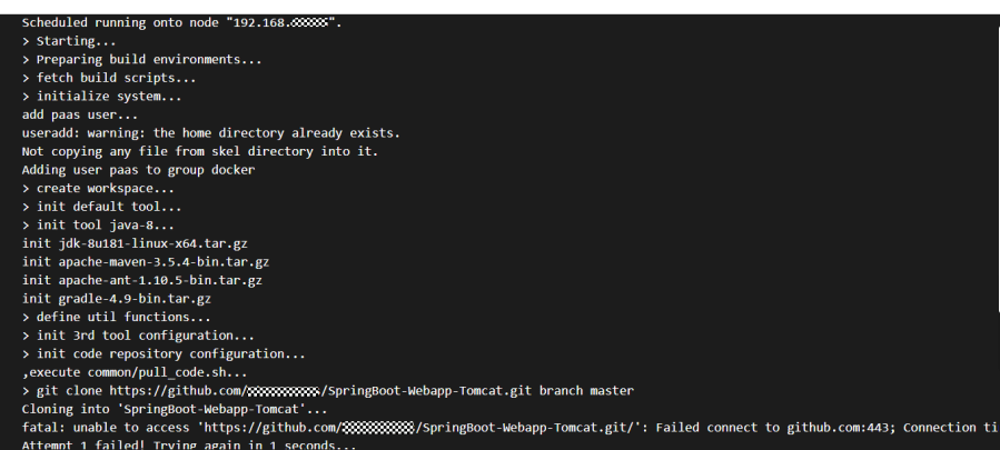

Code Cannot Be Pulled
See the following figure.
The possible causes are as follows:
  • If an application is built on your own node, the node may not be bound to an EIP. For example, in the preceding figure, node 192.168.x.x is not bound to an EIP. Solution: Bind an EIP to the node. For details, see Assigning an EIP and Binding It to an ECS .
  • The authorization information has expired, the private token of the code source has low permission, or the authorization information has been removed. For example, code cannot be obtained from the code source of CodeArts. This may be because the user password used during authorization is incorrect. Solution: Authorize the repository again. For details, see Authorizing a Repository.
  • The network between the self-built code source repository and the build node is disconnected. For example, a private Bitbucket is set up on a node in cluster A and the build is performed in cluster B. However, cluster B and cluster A are in different VPCs. As a result, their network is disconnected, and code cannot be pulled up in building. Solution: Connect the network.

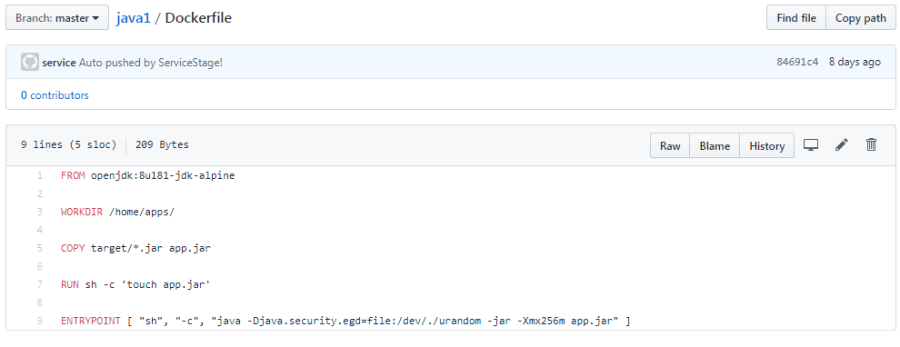

Invalid Dockerfile for Source Code Job Building
For details about how to write a Dockerfile, see the official website or ServiceStage template demo.

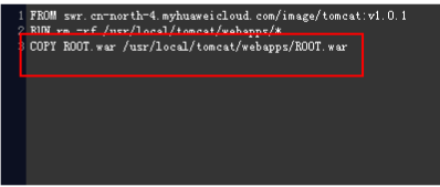

Customizing Dockerfile When Creating Software Package Building Job
When you select a software package, the system automatically uploads the software package to the current working directory of the image. The following shows an example Dockerfile:
