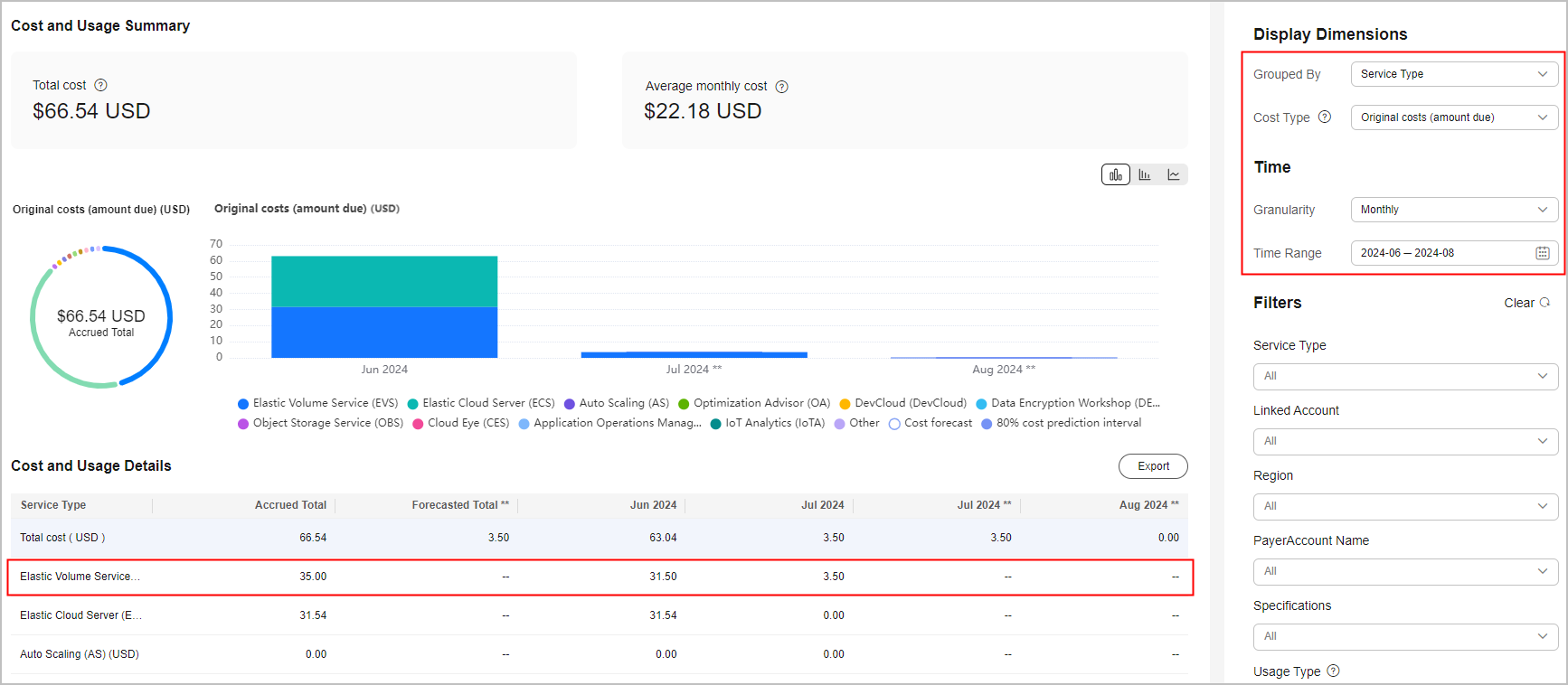

- View the monthly cost data (June to August) by service type.
In this example, EVS incurred the highest costs.

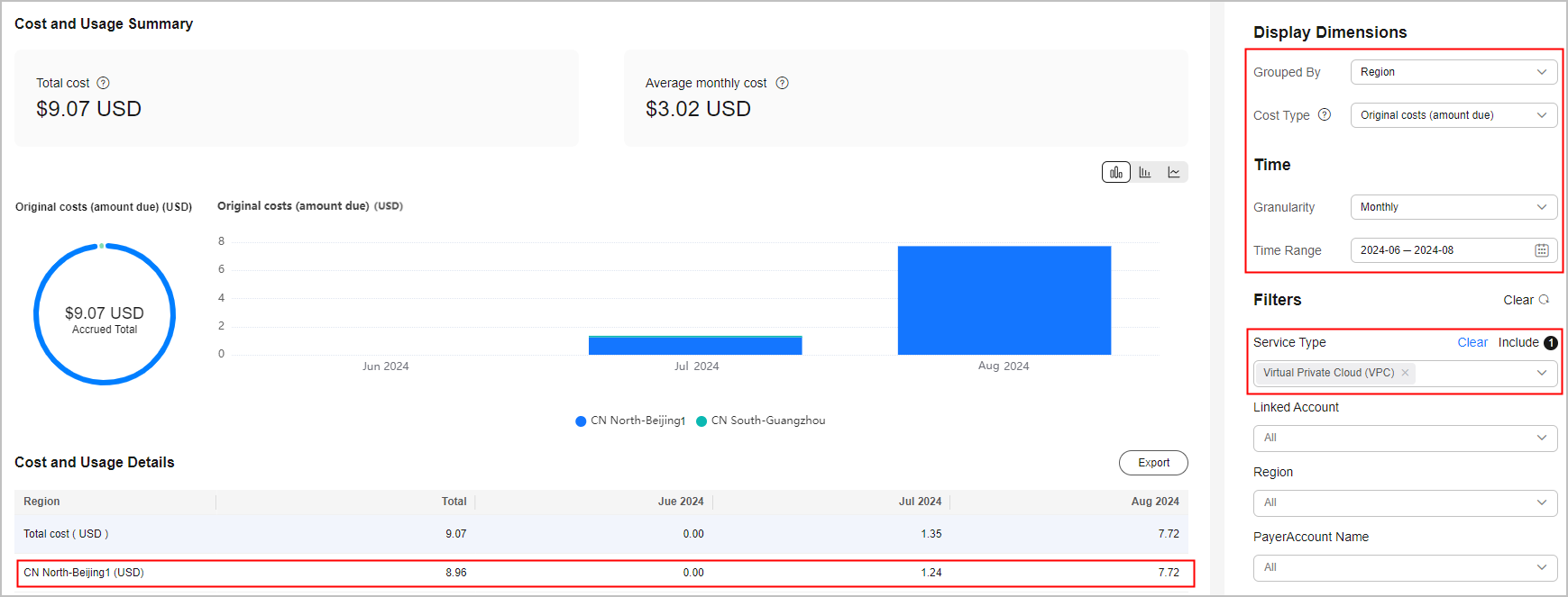

- View the VPC costs by region.
In this example, most of the costs are from the CN North-Beijing1 region.

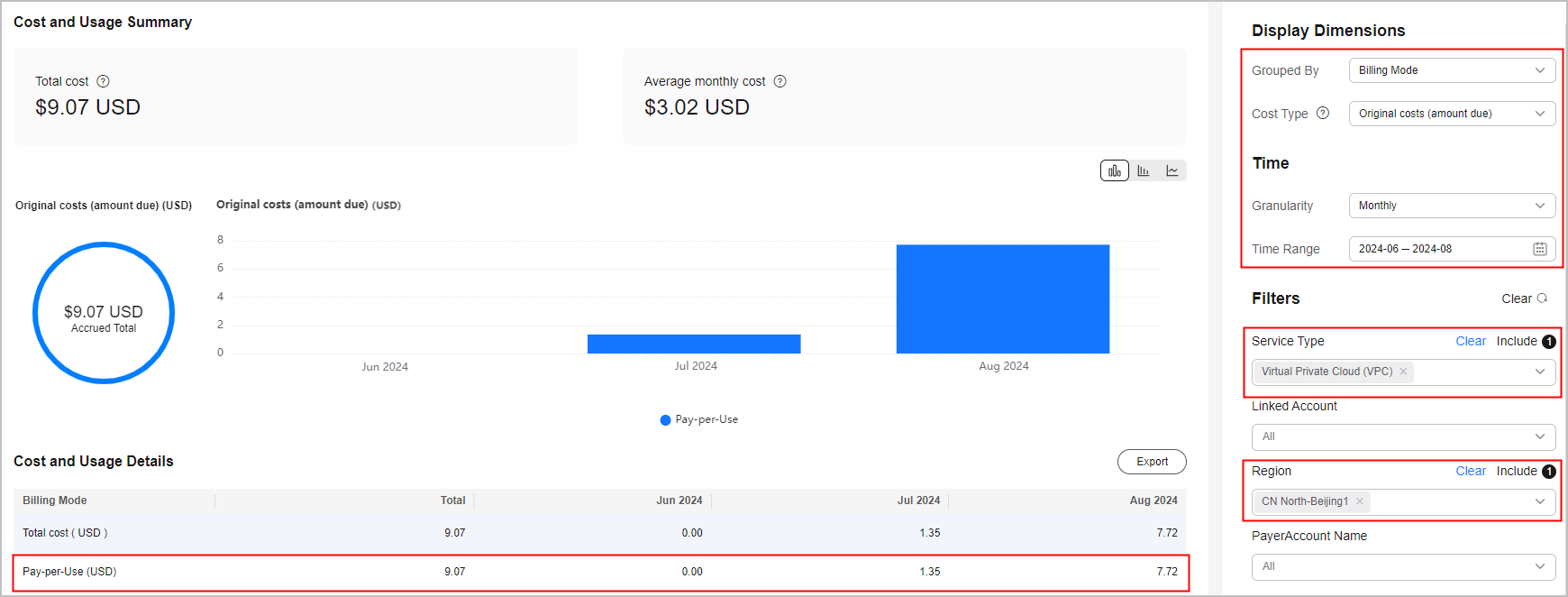

- View the VPC costs by billing mode in a specific region (CN North-Beijing1).
In this example, most of the costs are from the pay-per-use billing mode.
